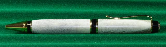

This is my second antler pen and the first one I did as a cigar pen. I like the color a little better on this one, but I'd still like it to be just a little more white. Guess it's just a hit and miss thing with antler, hey? Is one area better then another to cut the blank from the antler? This one came from the base of the antler, does the color change any as you go up? Just curious. Thanks!
R.T.
I've only made a few antler pens, but the deer antler I used had a nice solid white, ivory like look near the tips (the smallest diameter parts of the antler). The rest of the antler was pretty porous, and downright dark in places (it was an old, weathered antler).
Your's, however, looks plenty good to me!
Kyle
Looks really nice RT. Is it deer or elk? I think since you had a large piece being by the base, you may have turned past the enamel in some spots. Was it real white , then started to get the dark spots the more your cut? Anyways,I would have traded you my ugly green pen for it. I will be sure not to tell Rudolf, what you did last night. Anthony

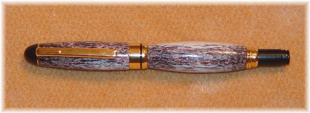

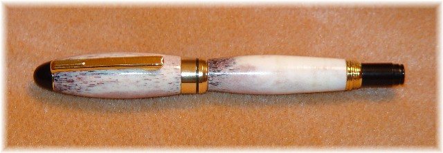

Here's a couple that were posted on the Finishing Forum.

Thanks Kyle, I have some more antler left over so I'll try one from the tip. Thanks!
Anthony, it's from a whitetail deer. And yes, it started out white and got darker the more it was turned, and then the side not showing in the pic got even darker and had a rougher feel to it once I started sanding it. And you keep that pretty green pen, someone will buy it and then you'll have to make another one. lol. Oh, and Rudolf stop by last night to thank me for getting rid of his competition for him. [:D]

This looks great. How did you finish it?
I sell a lot of antler pens, and I have found that most of my customers like the natural variations in color. I usually try to make sure that the grip area of the lower barrel is nice and solid white. This area gets the most wear, and even if a customer could wear the finish off, the bone still stay nice and polished looking if it they aren't handeling the marrow.
Thanks Eagle, I've done that a few times. But I'm not getting emails from anyone on the forum for some reason. I'm sure he must have answered me back, but I never got it. I can't figure out if the problem is on my end or if it's just the forum email. If someone would like to send me an email at rt@thewoodchucker.com I'd appreciate it, and if you could try it once with the forum email and then thru normal email it would let me know which one or both is not working. Let me know here if anyone does it, I sure would like to find out. Thanks!
Mike, I just used a friction polish that I got from CSUSA. It seems to work good, do you think that works OK?

I just posted a few pictures in my album of pens I made proressing from the tip to the base of one deer antler. They show the variation of color / texture / etc.
