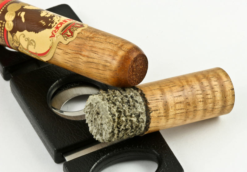

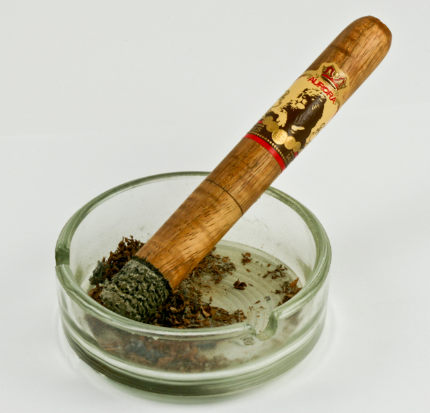

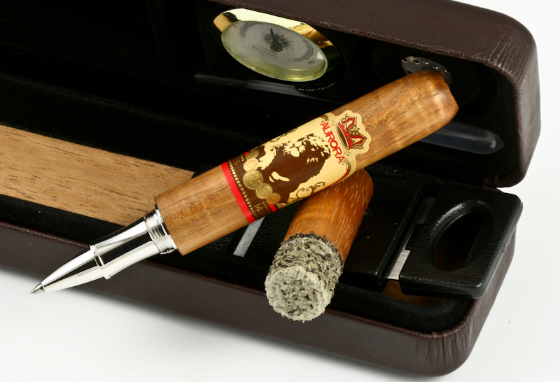

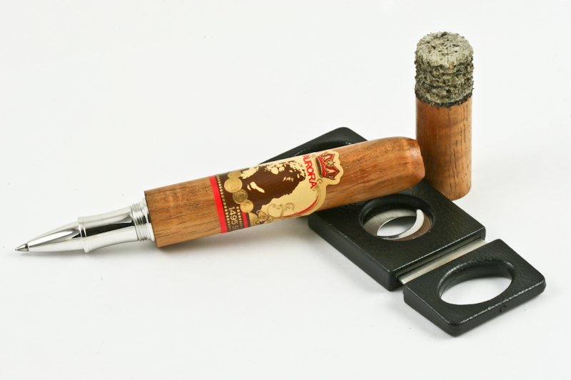

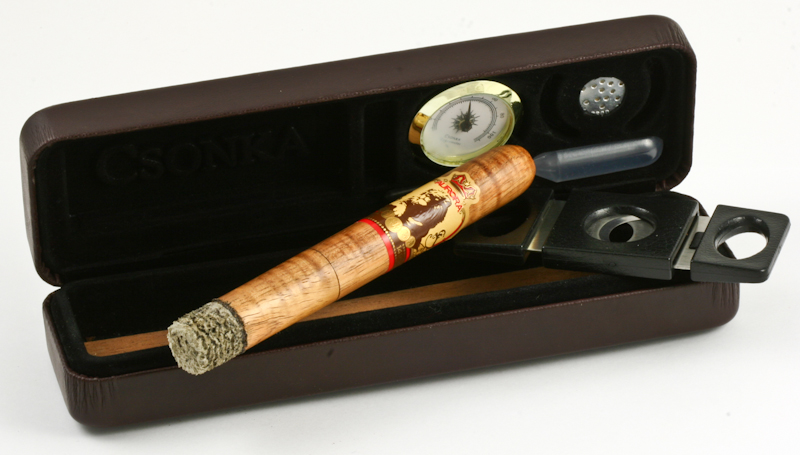

Finished this one up last night. A more robust pen.
Body is Hawaiian Koa (love the way it turns)
Ash is Buckeye
I'm not sold on the color combo. The pen is a precise fit/turning, but I tried Tgold parts and it was too much gold. I switched to Tsilver parts and liked that, but now the label blends in too much I think. I may go looking for a label that had black, silver and some red. I may end up going back to the Tgold! :biggrin::confused:
This pen has the end sliced off (as if by a cigar end cutter)
Enjoy.

very nice. if you want that kind of color scheme for a band, try Don Diego, Perdomo or maybe Comacho (one of my favorites).
Martin...truly a work of art. I find the ash tip very interesting. Also, simple detail, but this is the first pen I've seen with the end cut off and it enhances the reality and beauty of the replicated cigar.

OK OK Ok, Martin you are a genius! I wonder if i am the only one that noticed this, but your pen box is SAAAWWWWEEEEEEEEEEEEEEET. Did you custom design that yourself?

Still working on the detail for the tip. I cut off the tips of a couple cigars with the cutter and, like the ash, just start detailing with the Dremel. The ash end is rough. The wood is sealed, but it's got a lot of texture.
The real trick is getting this whole thing perfectly round so that even with a triple thread start it's a perfect fit with every thread. I'm not about to give everything away as I am still trying to figure things out myself. :wink:

I bought the leather travel humidor online. Only to discover that the inner components are terrible and cheap. I will likely find a way to adapt it like everything we do in turning.

I don't use any one particular kit. I have used pieces/parts from Churchills which I sometimes shave down on the lathe (and ruin at times) Gentleman's kit parts and even pieces of the Roman Harvest kits.
If anyone screws up one of those kits while making a pen, let me know. I have spare parts galore.
For those who want to know how to make one of these. All I can say is to get into the shop and start asking questions like "how do I get cap parts inset into the cap?" How do I get the cap and body together and turned round so that everything is perfectly round on a triple start thread?"
Out of every 4 I make, 1 is a failure. It may look good from the outside, but it is minutely out of round.
I can tell you this... if you don't have a collet chuck of some sort, I'm not sure how else it can be done.
