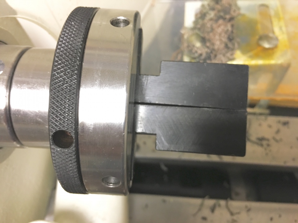

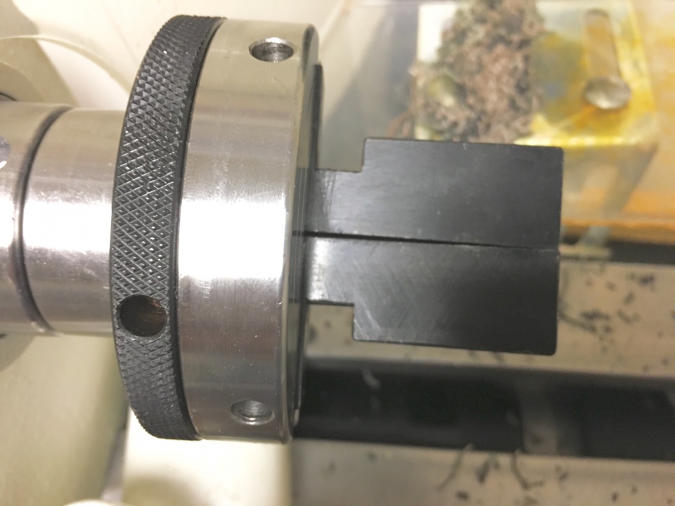

While we're on the subject I just got this. It does not close flush/equally. Is this common or unusual.
Maybe the better question, Is this acceptable? Not in my book, but I'm use to working on a metal lathe with tighter tolerances. I would think a gap at the back is better than at the front. As you tighten it and the jaws flex, they should be closer to parallel.
Thank you...acceptable works for me.....still might exchange it..has been serving its purpose.

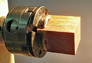

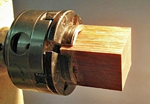

I will be turning 2x2 x ? stopper & pizza cutter blanks. This picture is from Niles website.
(All rights reserved Ruth Niles 2015
All images and content within this site are copyrighted and intellectual property of the owner.)
Since I'm using her kits I'll assume it's ok to use the illustration. I have no knowledge of chucks. What is the chuck (brand/size) being used. Thanks

Looks like it could be a Oneway Talon w/#2 jaws.
This mounting works good for square stock. If rectangular or odd shaped, turn a tenon first... then mount in the chuck.
While drilling the hole fore the stopper, turn the face flat while still
In the chuck so the stopper snugs down flat to the wood.

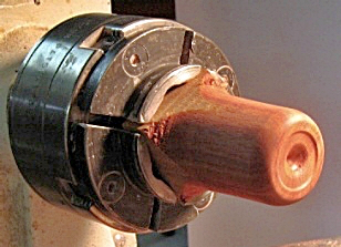

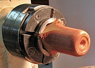

Gothca thanks....does this go against the rules? These pictures are from Niles website.
For square stock that is OK but don't be overly aggressive with your cuts. Your other choice, if the piece is large enough, is to turn it round between centers and make a tenon to hold it. I've done it both ways.
