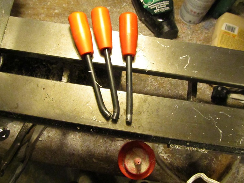

the 4 jaw chuck i use to hold onto my blanks is on there but GOOD. I've bent one of those cheap pry bar things that came with it trying to screw it off.

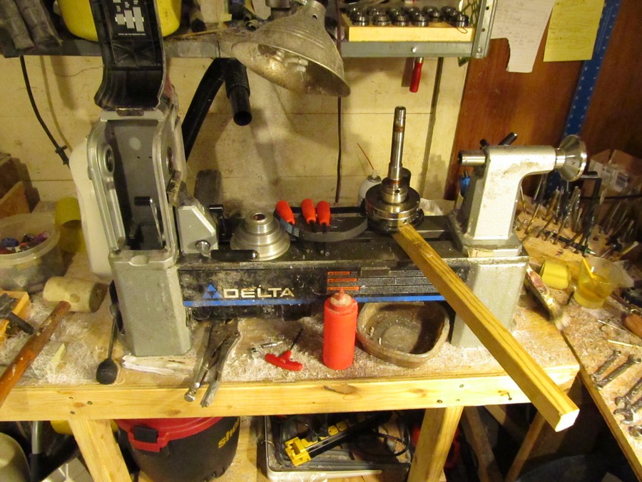

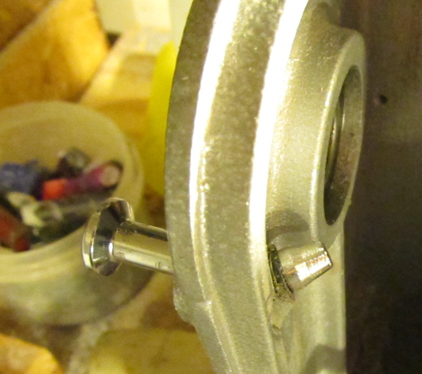

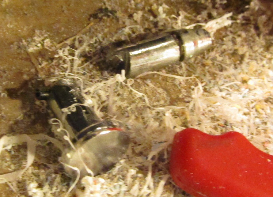

Okay - had the index pin engaged, headstock "locked" - piece of long wood in the chuck jaws. Pushed down on it and snap. Index pin broke. Had to use pliers to pull pin out and turn to disengage index pin. So now what?

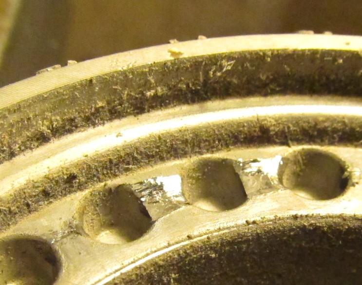

You have joined a long list of people you have discovered that the index system is not a spindle lock. Glad the pin broke rather than the casting. You may have damaged one hole though.
Most lathes have a place on the spindle for a wrench. I like the thin bicycle repair style wrenches personally, but there is generally one with the lathe when purchased.
Use the wrench to hold or lock the spindle.
To get the threads to release, use a block of hardwood -- about a 1 1/2 inch piece of maple turning stock between the jaws. One about 18 or 24 inches long will give leverage You want firm pressure as most all the force will be on 4 screws holding two jaws. Breaking them is more of ugly. Big heavy strap wrench around the chuck body works too.

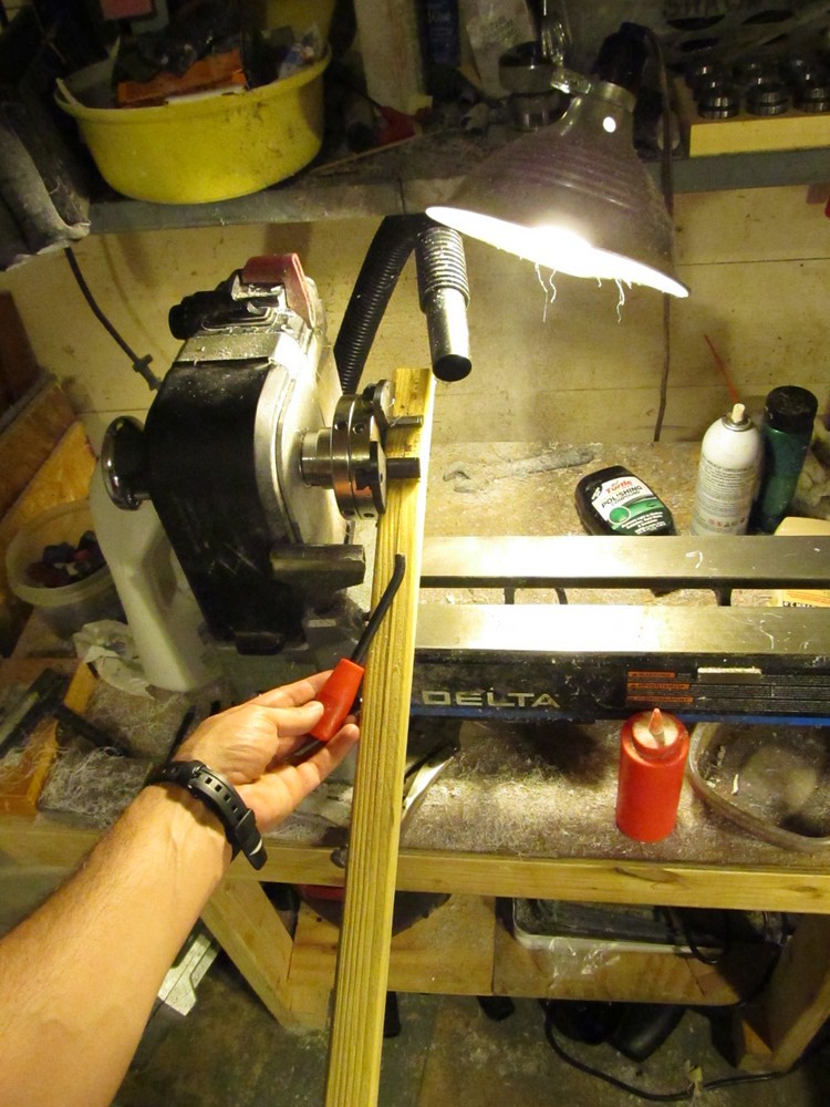

Do you have a means to hold the headstock spindle from moving? Big enough handle/wheel hopefully?
Do you have a socket set and a breaker bar? Mount the socket in the chuck and put the breaker bar on it (a rachet should work just as well). A chucked piece of wood that you could put a pair of vise grips on would also work.
Hold the handle/wheel as tight as possible with the breaker bar pointing out, slightly above parallel take one solid hit on the end of the breaker bar with a hammer (ideally a rubber mallet). This should break it free ...
I will second the idea of tapping on the breaker bar. The idea is to hold a significant amount of torque on the bar WHILE tapping. Maybe try a few drops of penetrating oil on the area that is "stuck".

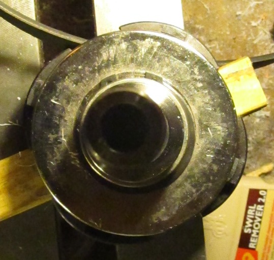

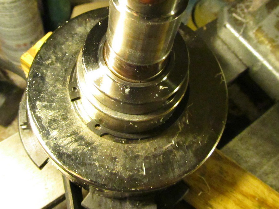

What I do not see is a wrench on the flats of the spindle right next to the head stock.
You cannot unthread the chuck with the tommy bars and a block in the jaws. They are just working against each other. Spindle needs to turn and that is directly next to the headstock.
Shawn, I have the same cheap chuck and have had the problem once. Although, I was able to get it off with just the tommy bars, I have an idea for you.
DOH!!
Why haven't I used the spanner wrench??!!

Shawn, does the headstock spindle have the holes on both sides? If so you could lock the piece of wood between two objects or in a vice or something of the sort and use two of the tommy bars, one in each hole. That would give you more power and make it less likely that you would bend the bars. I would imagine a jerky kind of motion would work better than steady pressure. You don't need to power through it, you just need to free it up slightly.
That's not a bad idea. I may just try this.
