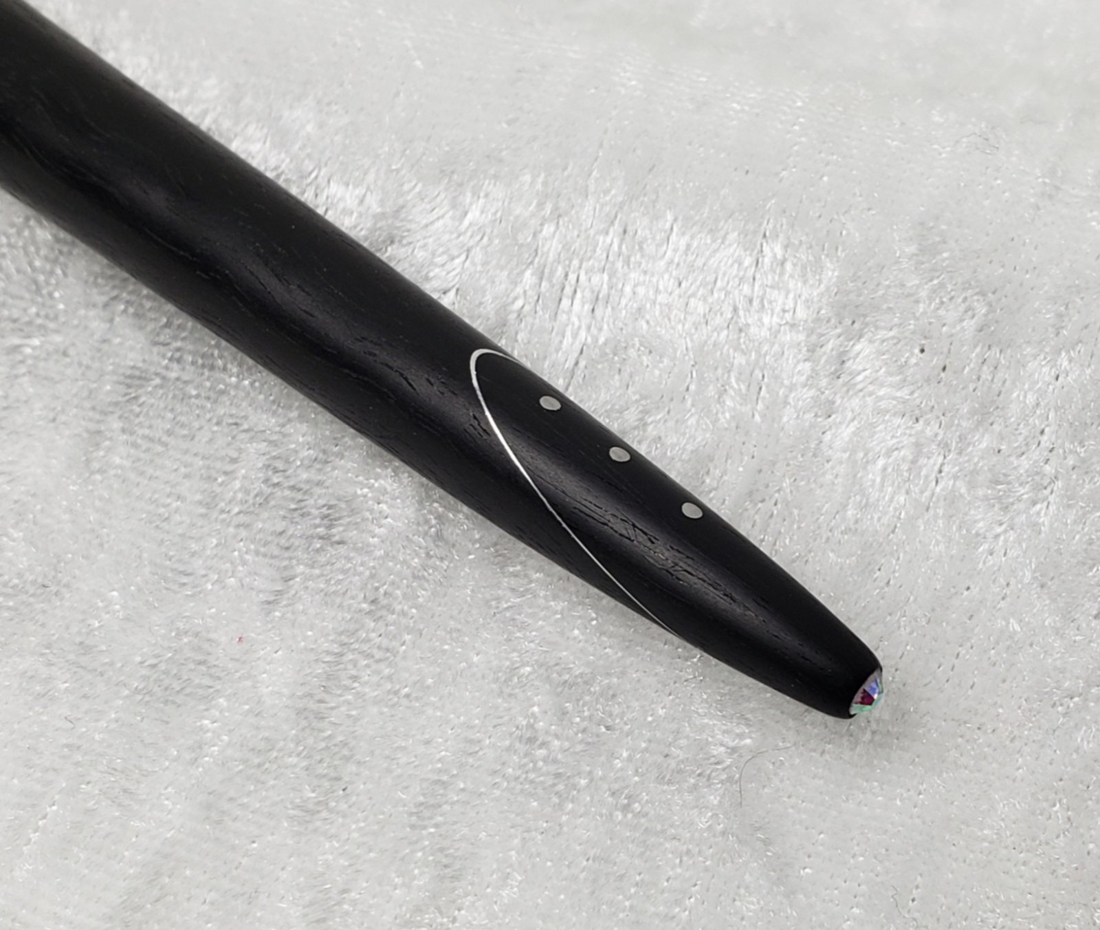

I have been turning for about 2 months now, mostly pens. When I first started my son gave me some 13" to 14" sticks about 3/4 x 3/4. To practice lathe turning I started making some kids wands for my 9 and 10 year old grand kids. The only chuck I have is a 2 jaw pen drilling chuck which I have been using along with a live center on the other end. Depending on the type of wood, as I get farther away from the chuck it starts chattering and have had a few break close to the tail stock. I have only carbide tools.
