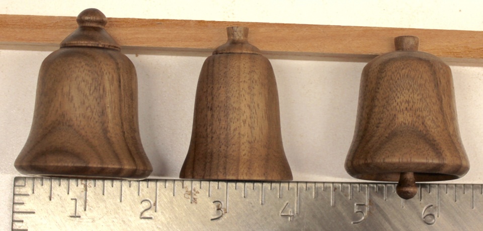

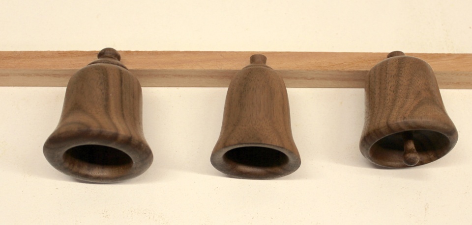

Lets use this thread to post whatever we are making for this holiday season (Turning - but not exclusively for you flat work folks).
So post away! I have three small bells that I will post tomorrrow. Until then I'll start with a pickie from a few years ago:

The bells will be a bit smaller, but nonethless, FUN!

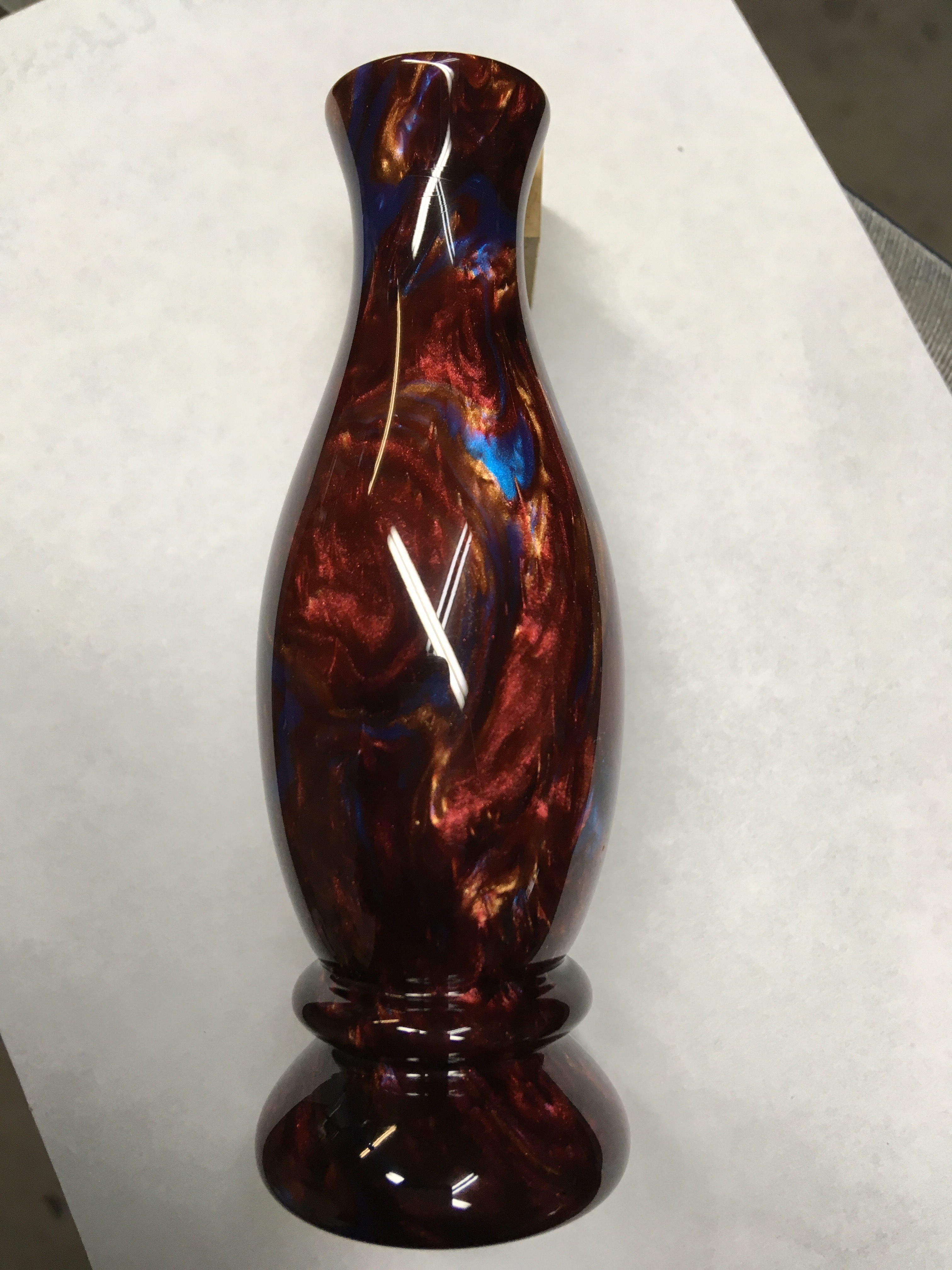

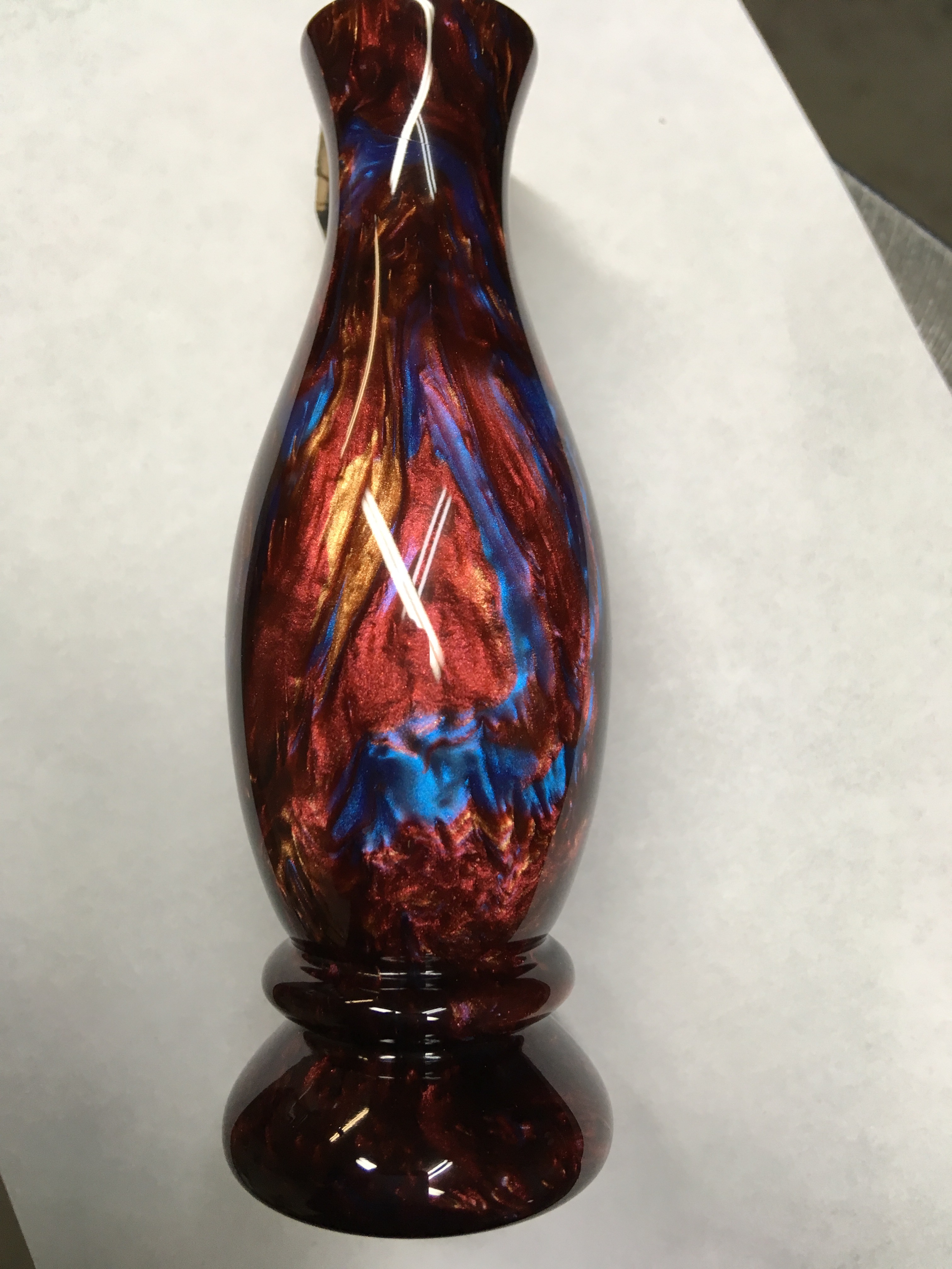

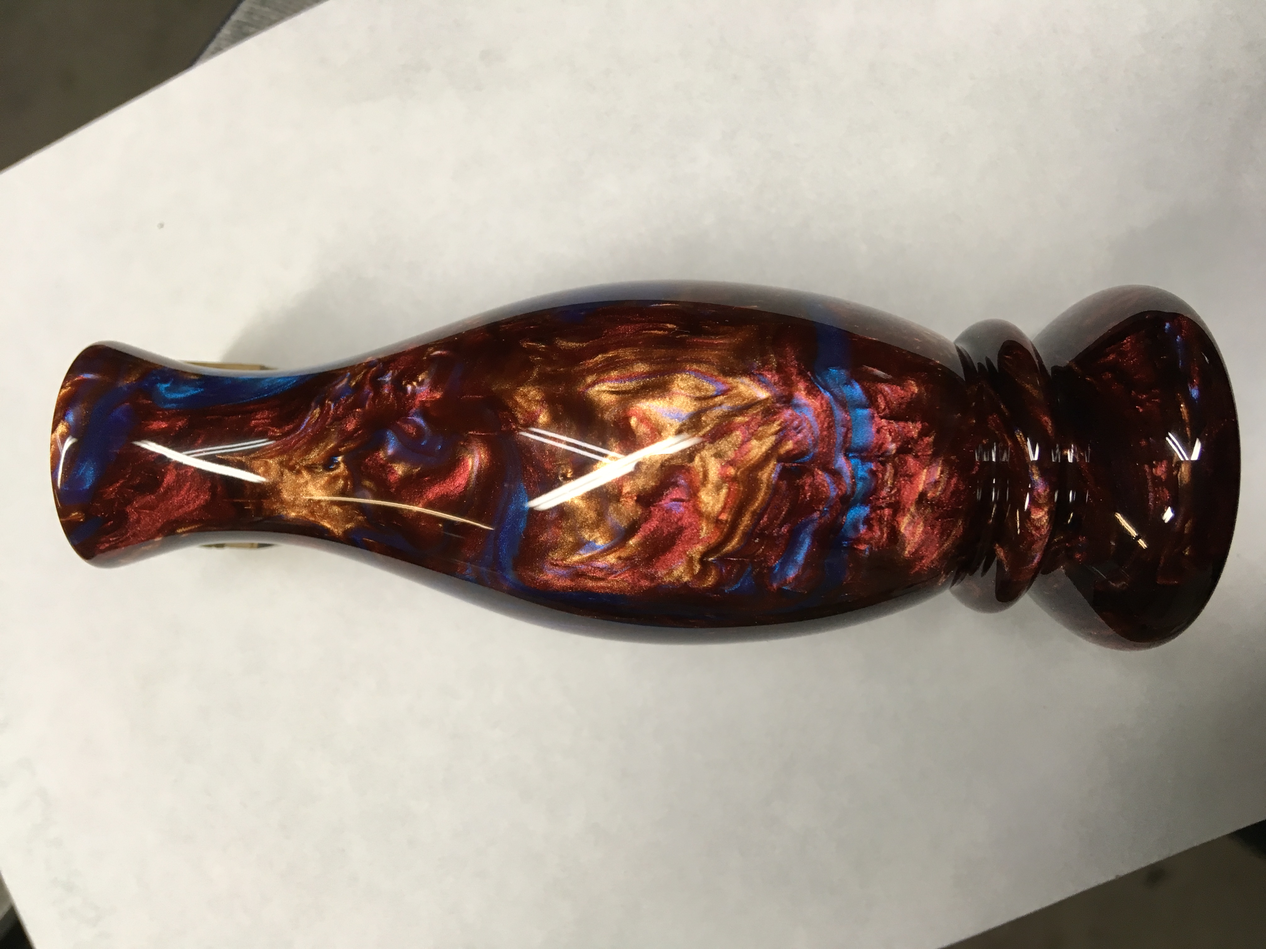

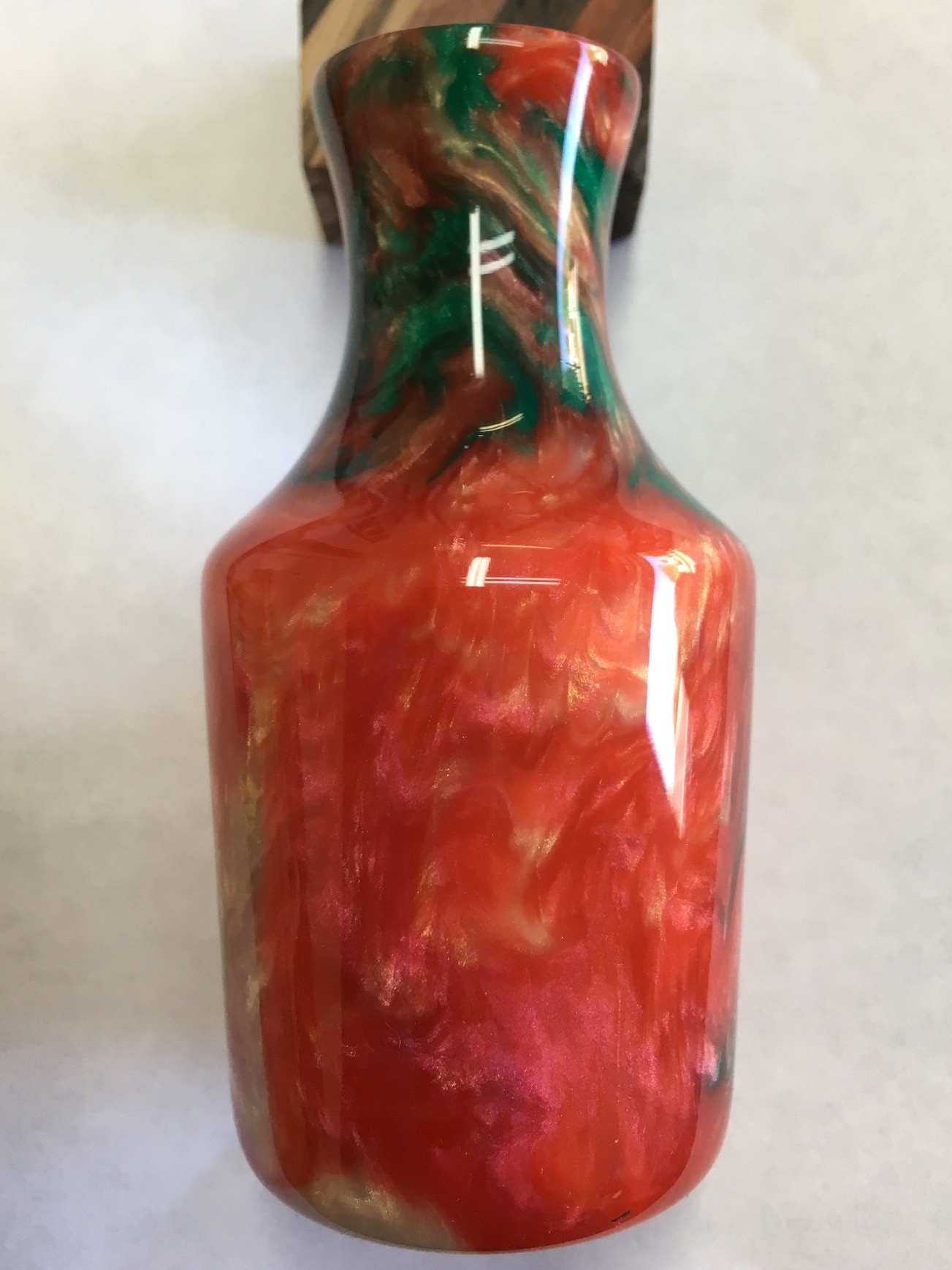

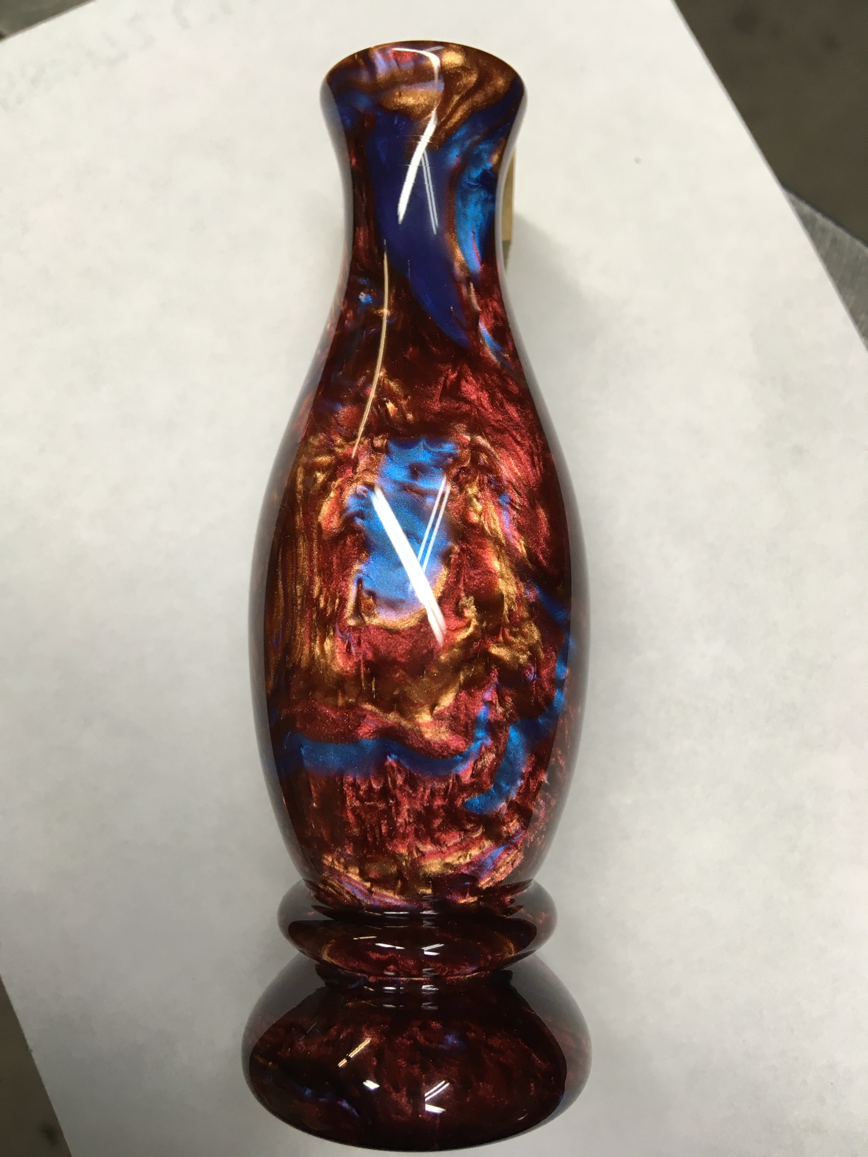

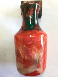

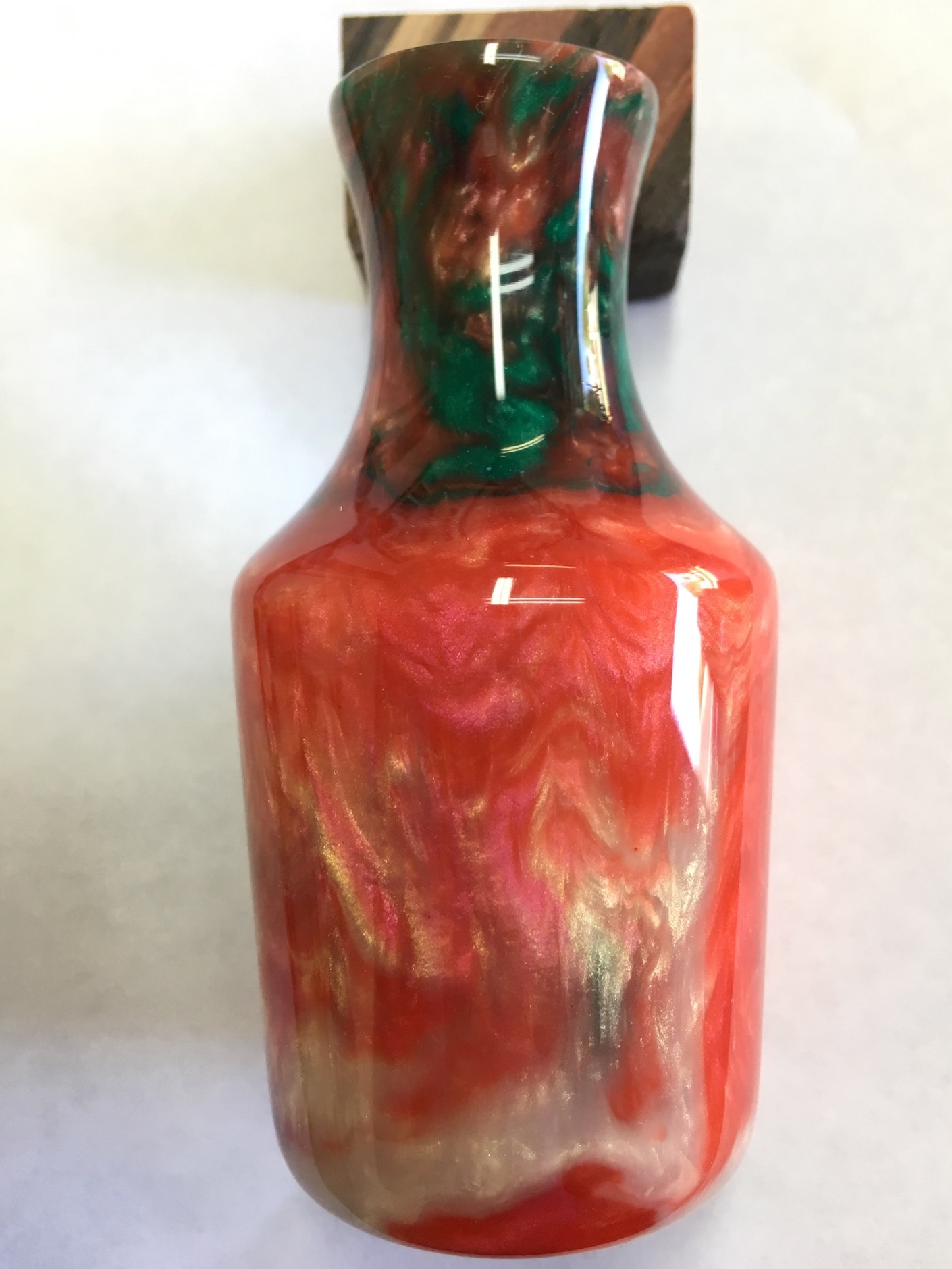

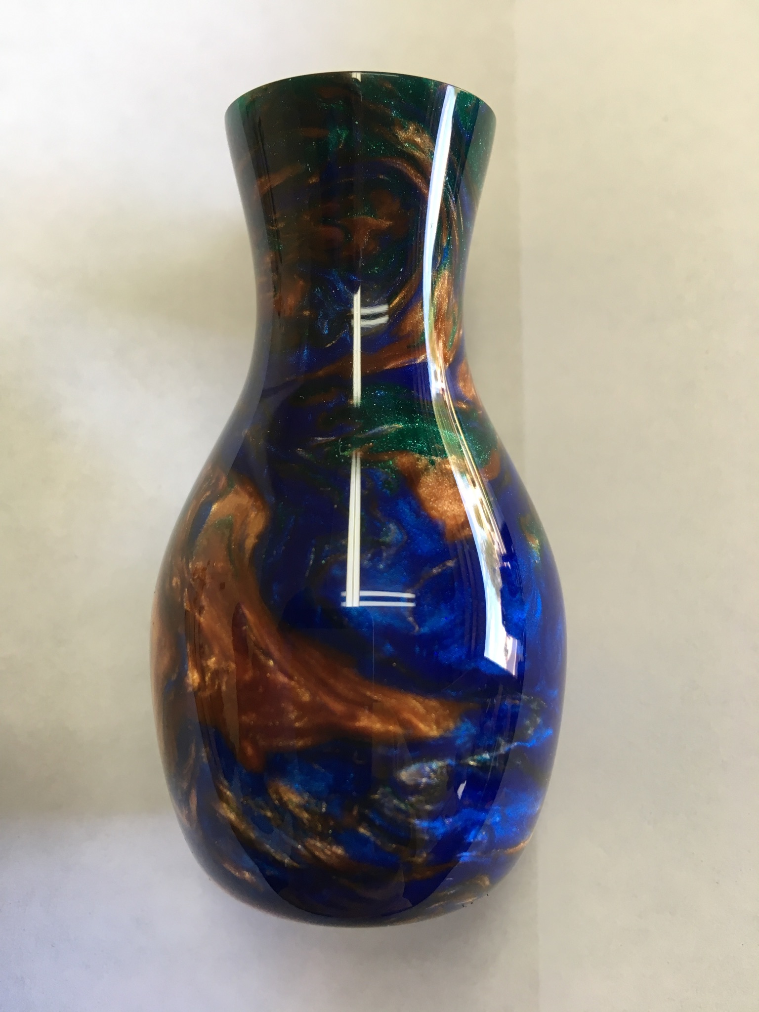

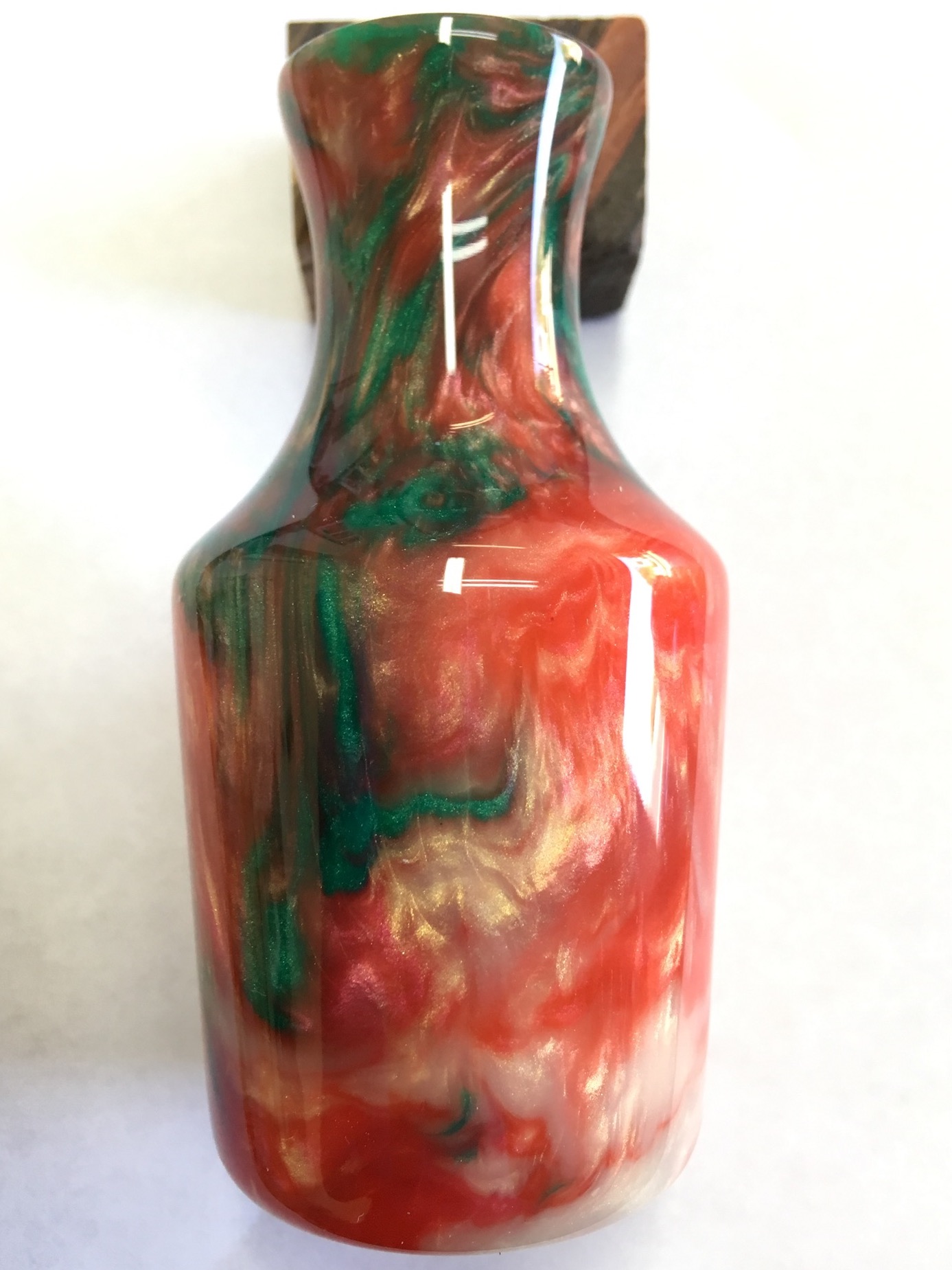

Great idea Mark. My mini acrylic bud vases were a hit with the nurses & MA's at the clinic so I'll be making some to give to them. I turned one today and will make another tomorrow, and probably 2 every weekend for the month. I'll get pics up tomorrow evening.
Full disclosure: After inspecting the one today I need to sand and polish it again since it showed some sanding marks. I tried using abrasive paste without using the first 3 MM pads beforehand and it didn't work out. Trying to save time cost me quite a bit more, lesson learned.

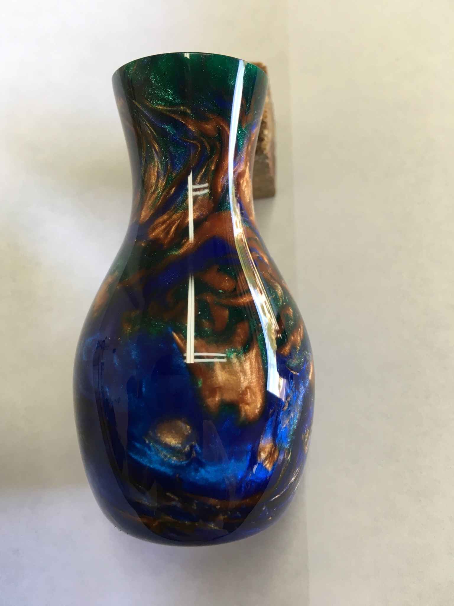

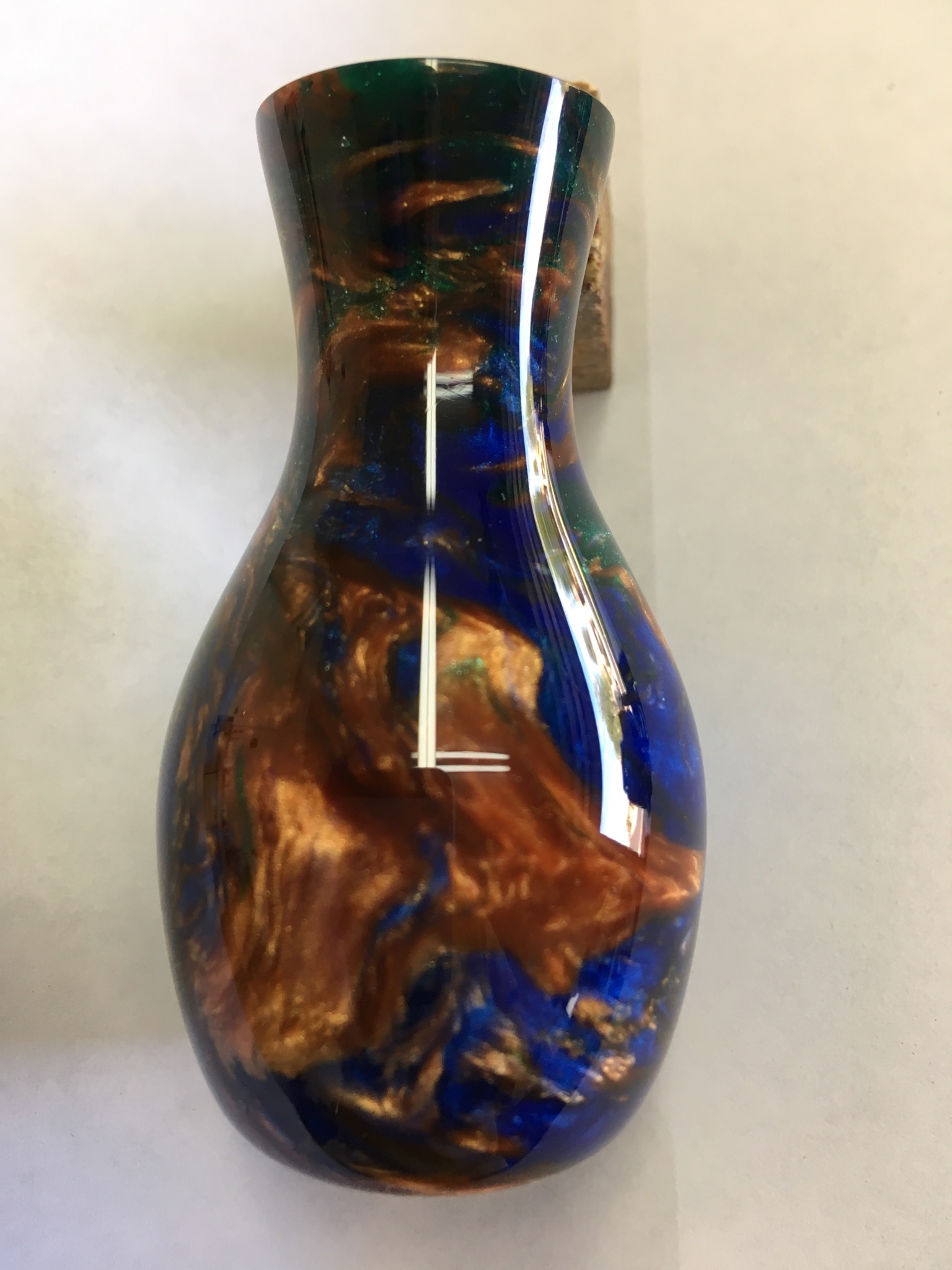

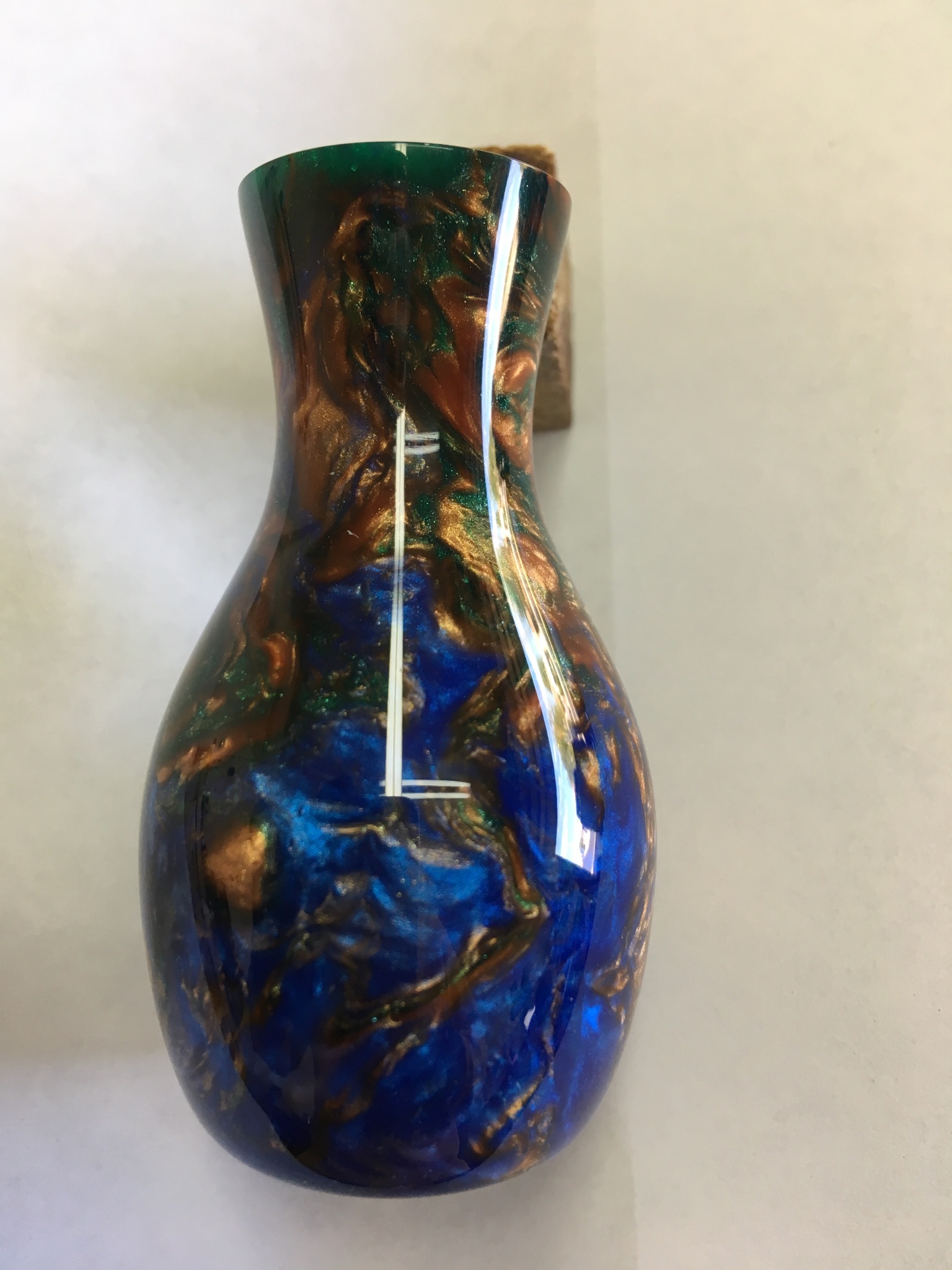

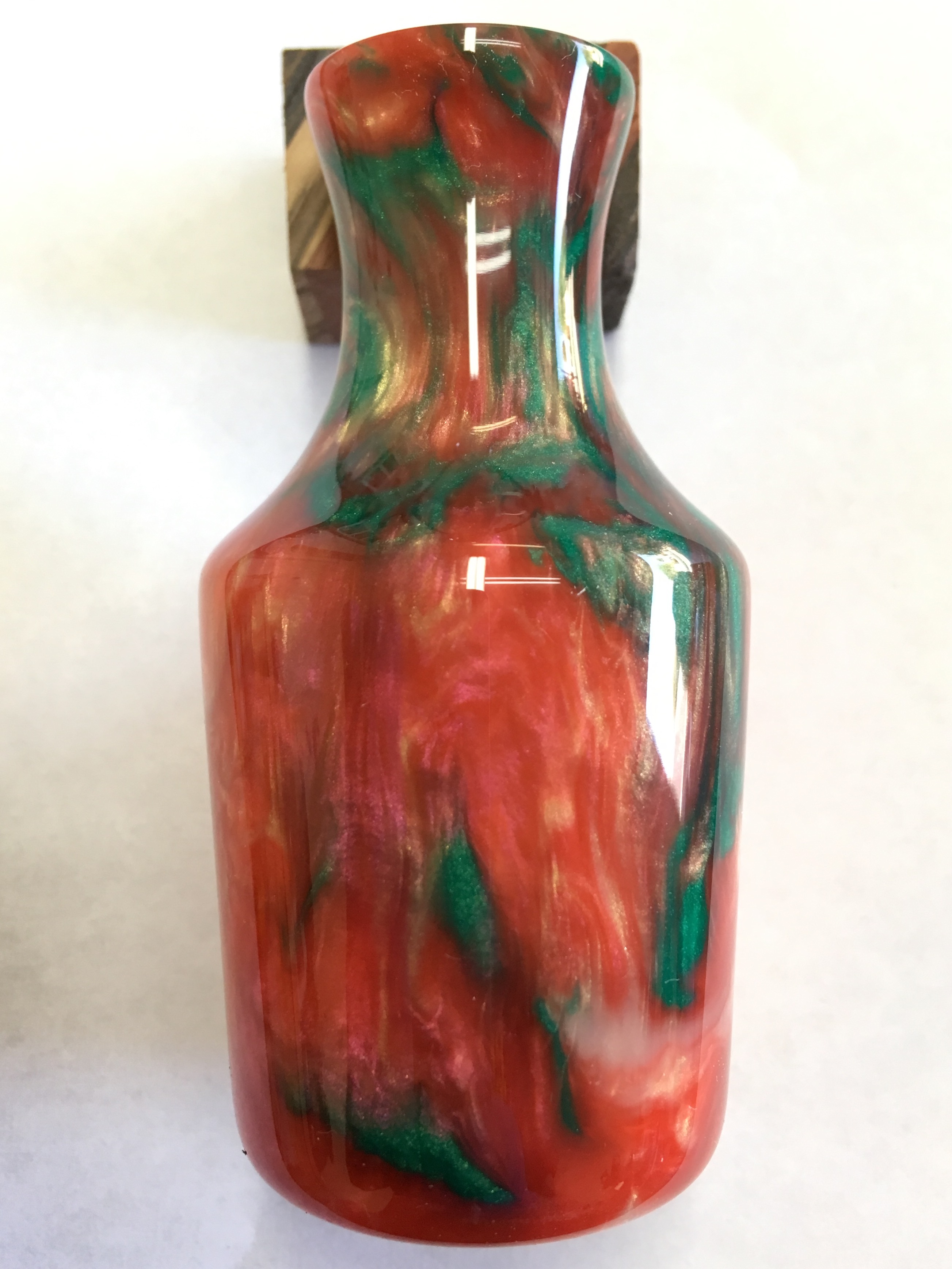

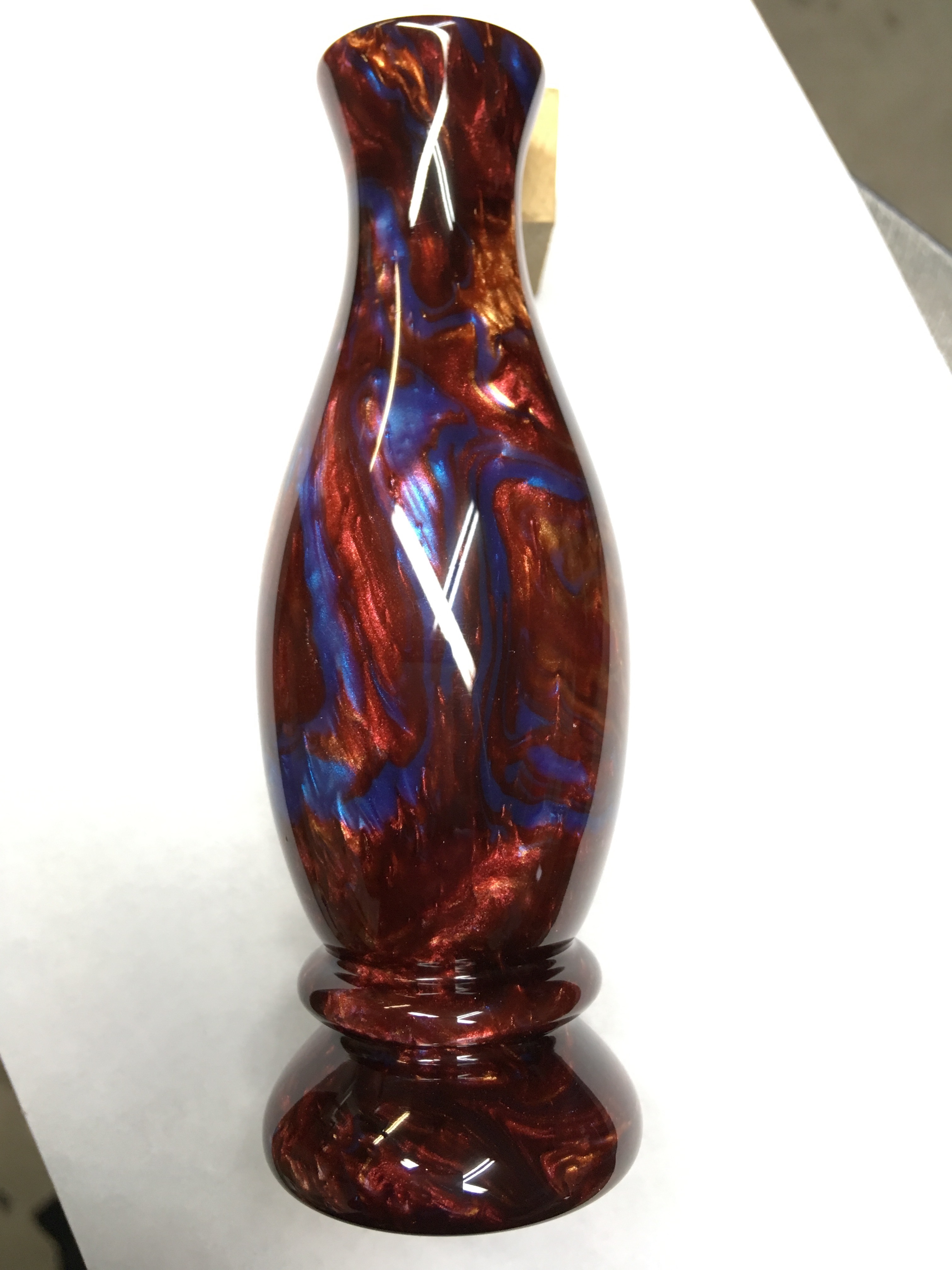

Twig pot/Bud vase #1. I cast the blank with Silmar 41 and colored with Pearl Ex turquoise & bronze mica powders and Castin' Craft (dark) green dye. I recently got the powders and it's the first time I've used Pearl Ex. It costs several times more than the mica I buy direct from China but the colors are brilliant.

Thanks Mark. I cast blanks for these anywhere from 3.5"-4.5" tall and 2" diameter. They're actually mini twig pots, but I've given a few as birthday gifts with little artificial flowers in them to some ladies where I work and they love them, and they only take a tiny bit of space on their desks. I got busy doing some shopping today and only turned one after I was done, sanding & polishing can wait until I get home from work tomorrow, along with the cleanup. What a mess!
Thanks Jay. I have a bunch (like too many) of nice spindle blanks that size, so I'm gonna steal your design and play this week. I've got 4 relatives that this would fit their interests.
Cool! Glad I could help out even if I was completely unaware of it. As for stealing my idea, I stole yours for making modified slimlines so this makes us even! :biggrin:
I actually turn these like a bottle stopper, the only difference being that I sand/finish the top before threading onto the mandrel since it obviously shows. It leaves a little mark if the top is concave but so far the buffing wheels have taken care of that. Strangely enough, it doesn't leave a mark if the top is convex, I can't figure that one out. Yes, the hole is threaded, but that's not even noticeable once a few flowers are in it.

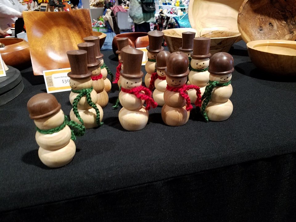

I turned a baker's dozen of these snowmen to put on my craft fair table this fall. They have been moving slowly but steadily. The first weekend they paid for the table fee.
My wife crochets a simple scarf for them from red or green yarn. She draws the face on them and I burn it with the pyrography pen. They are turned (mostly) from ash with black walnut hats. A couple elm ones got included as well.

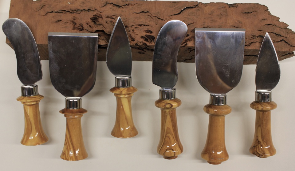

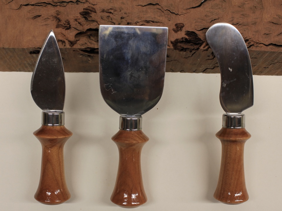

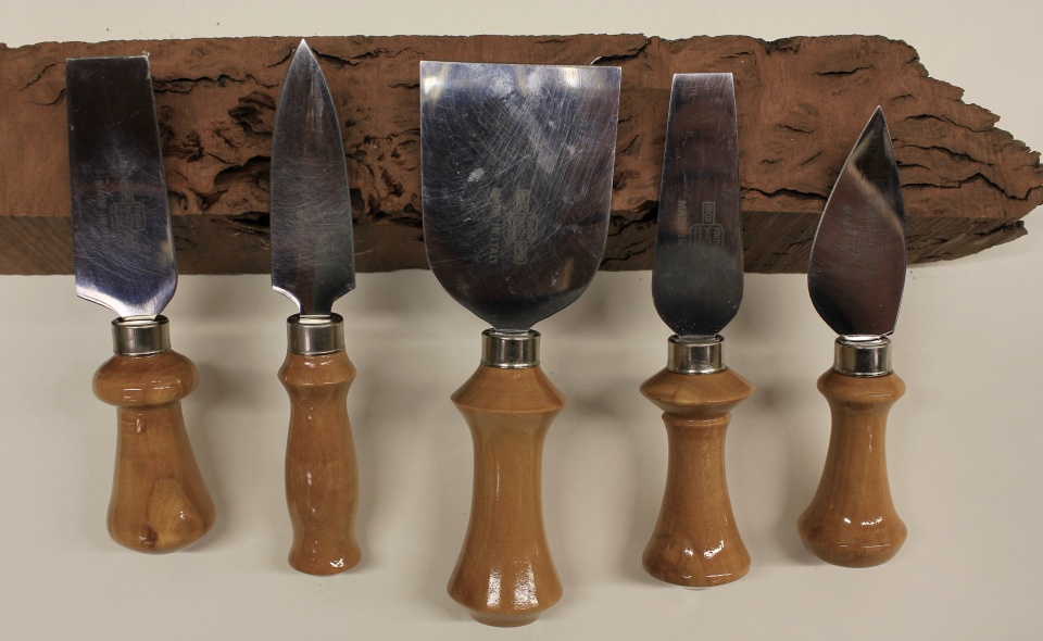

OK, some of this (Dec 2017) years gifts - these are for family/friends.
The first set of cheese cutters are well worn/scratched, as they are a set that my wife and I received years ago, and the maple blanks were chipping, swelling, etc, ... so I dismantled them and used the 5 blades with Olive wood blanks (From Robutacion).
The second and third set used Olive Wood from Robutacion (a box in 2014), and blades from CSUSA.
The final set used Cherry Wood from my yard, and blades from CSUSA.

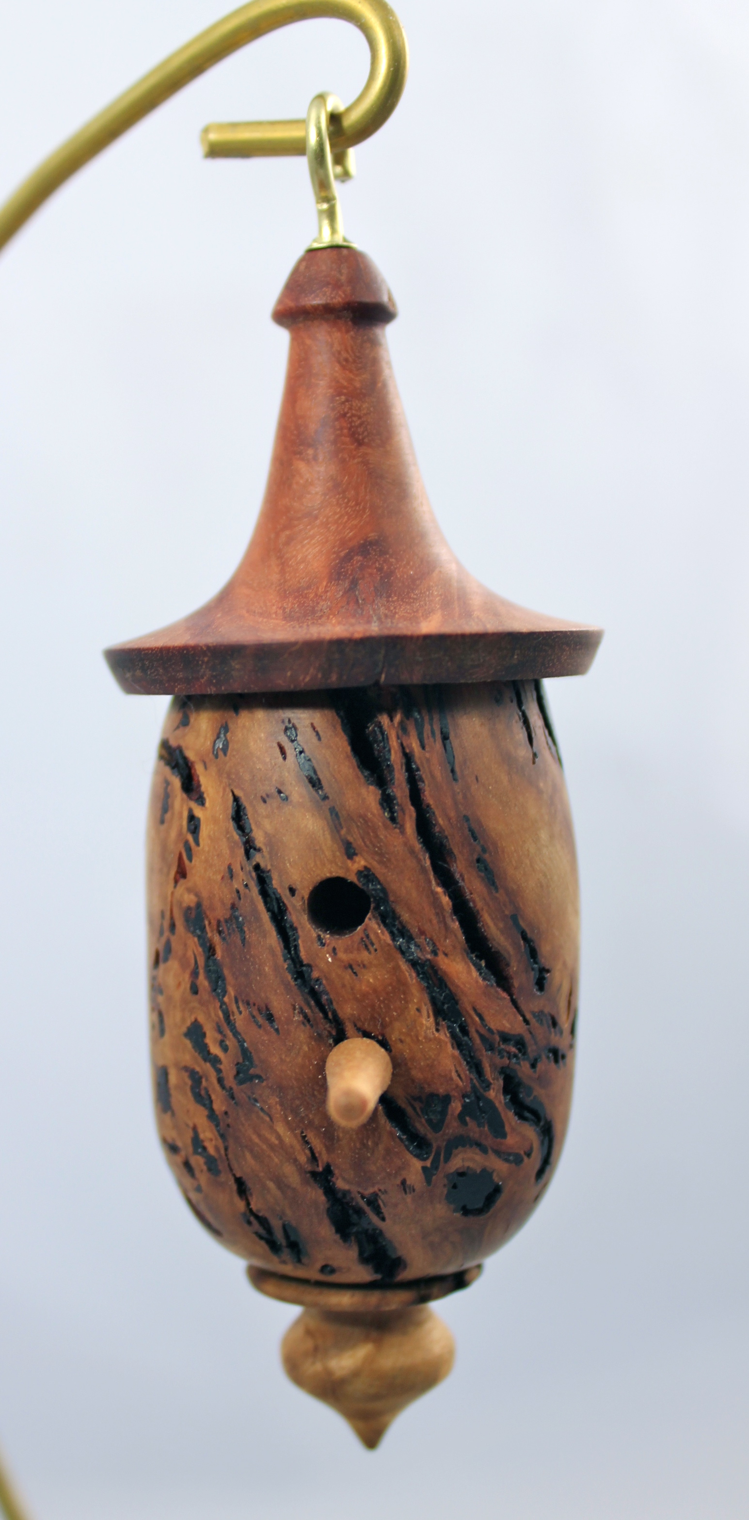

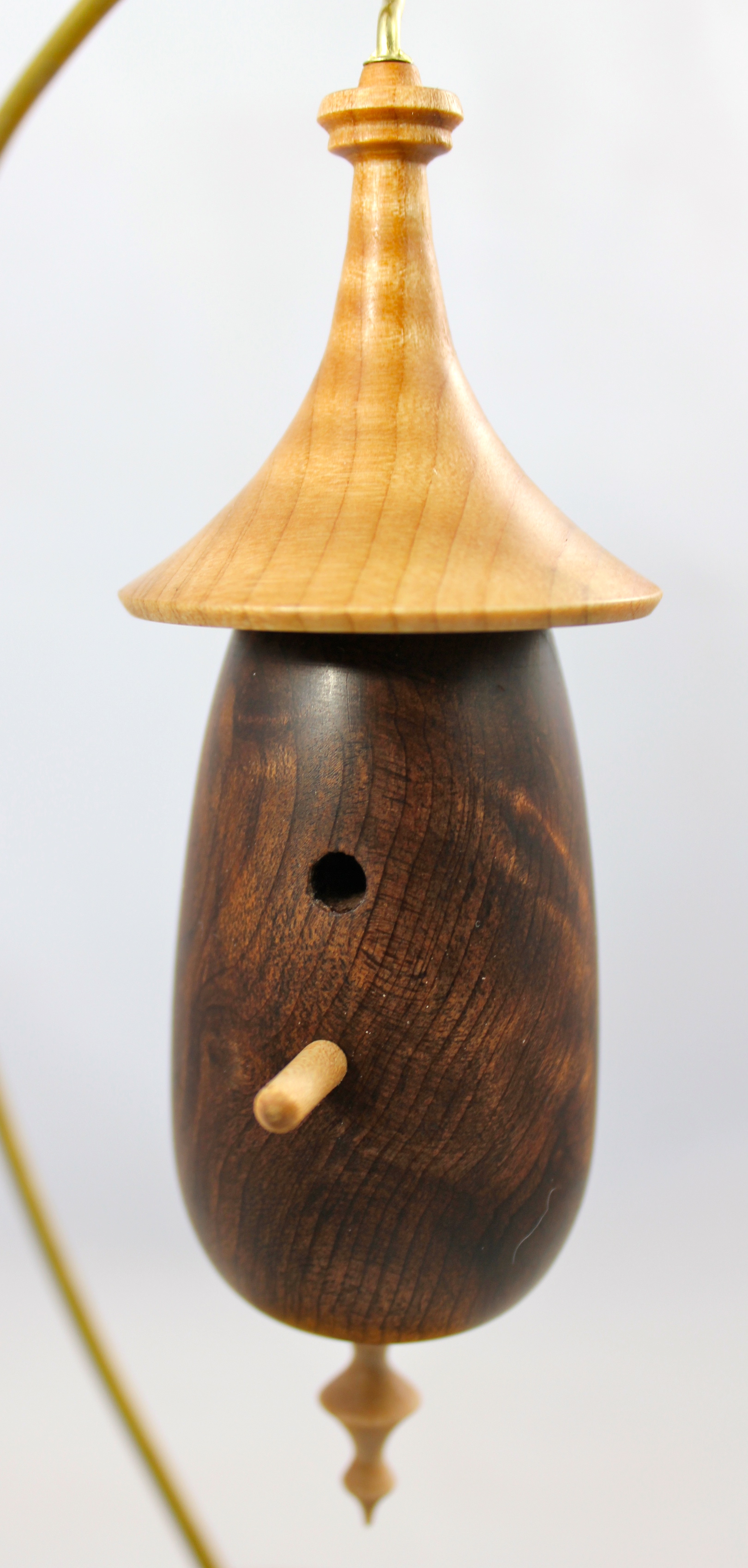

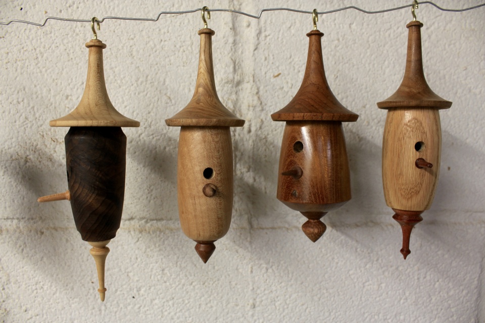

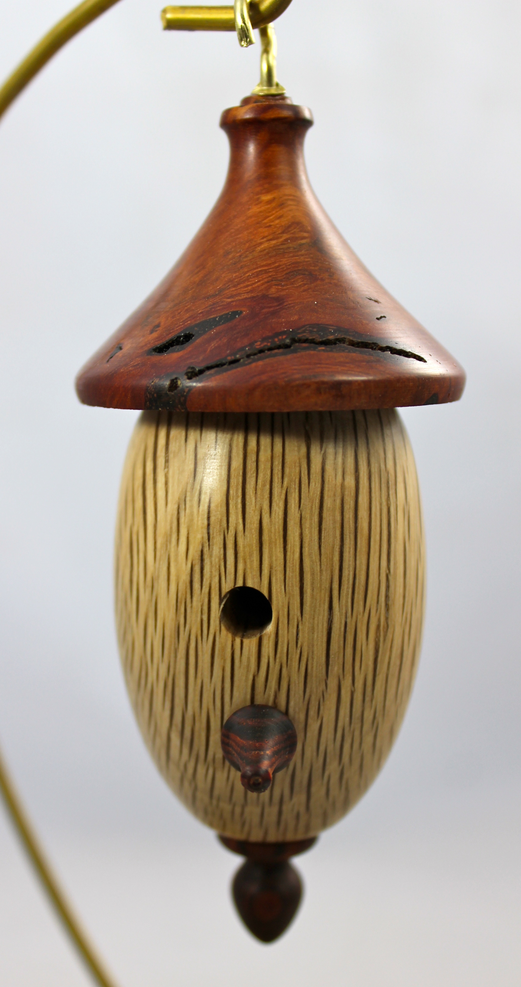

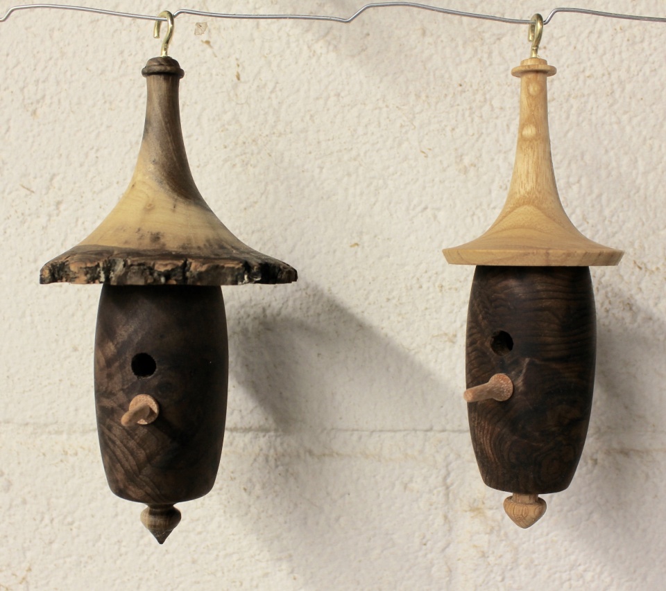

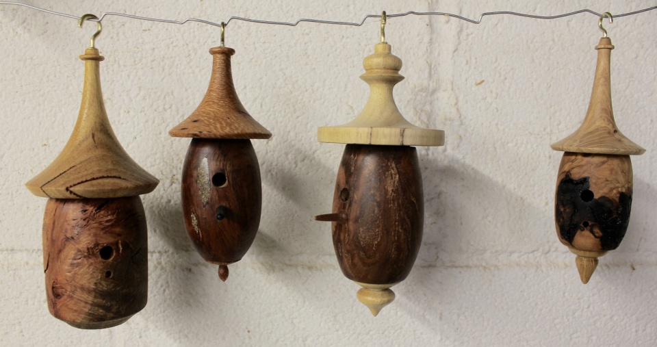

A Few Bird House Ornaments
The first set are timbers from Robutacion in Australia. Not all is done, need a few more finials and perches.:
The last two sets are misc woods:
These are for my family for 2017 Christmas.
