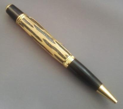

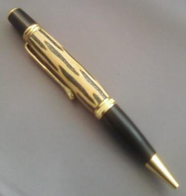

This is a Wallstreet ll pen I made for one of my bosses for Christmas.
It's Cholla cactus infilled with ultra fine green glitter.
Comments appreciated.

When I used to live in Tucson we'd see tons of Cholla "bones" on our hikes. Nice use of the cholla + glitter.
Did you cast the cholla? or just used CA to stabilize/in fill?

Look for pieces that are between 5/8 and 3/4 diameter. Cut to length of tube plus 1/4. Take a piece of dowel rod about 6" long and cut a slot about 3/4 long in one end. Wrap a piece of 120 grit sand paper in the slot so it will just barely go in the center of the chola. Sand it out until the pen tube fits snugly then CA the tube in place. Sand the ends flush and infill the holes in layers (this helps to do away with voids) (damhikt) Place on lathe and turn to size with your favorite scary sharp tools. Finish seal and finish.
