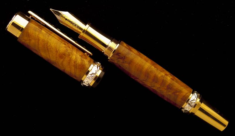

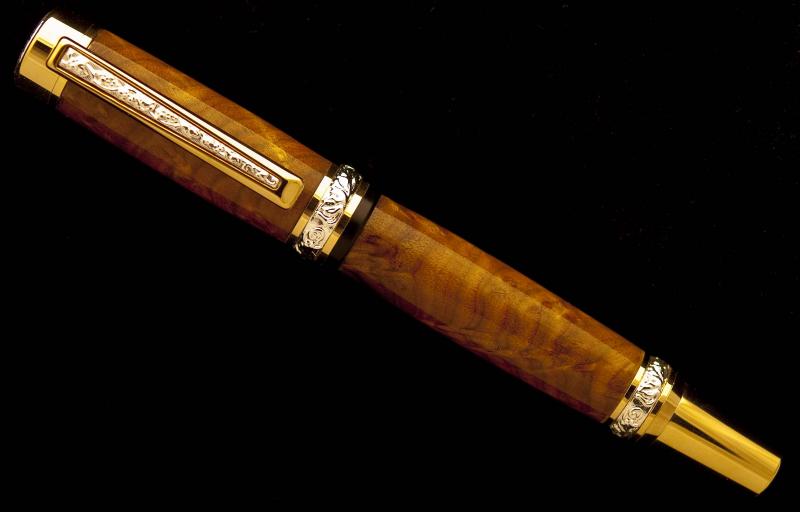

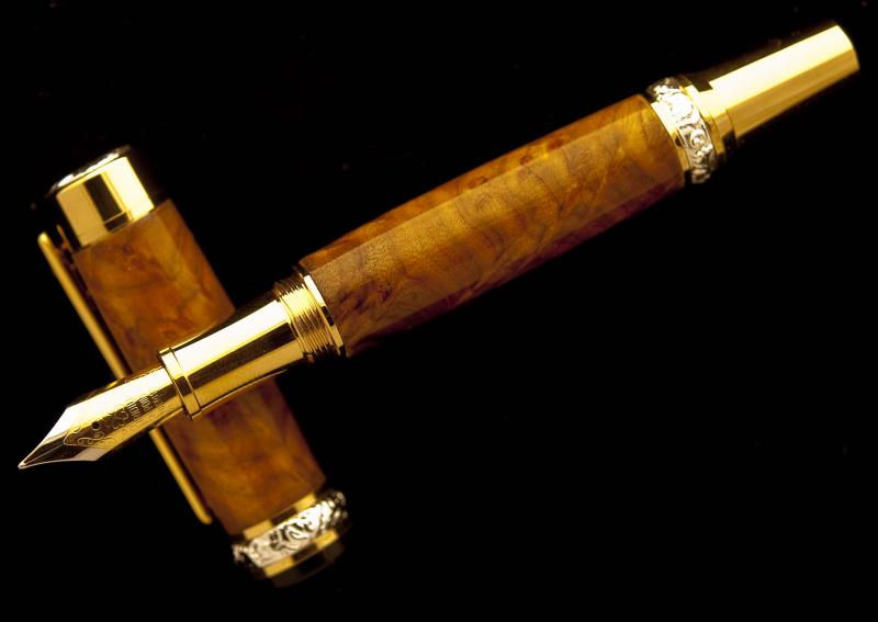

Made it this A.M. It's Chittam American Smoketree Burl from Exotic Blanks on a Cambridge TiGold with silver accents Fountain Pen. I got this blank in my Christmas basket concocted by my son, David, and Dawn. I learned from the Exotics site and others that this particular burl is one of the rarest burls in the world. It is apparently indigenous to the Southeastern United States, grows in a handful of very small regions and is virtually unheard of outside North America. From what I have seen, it does have a rich amber color, fine grain and curly character to it. The pen looks better in person and is more amber colored than in the pictures. Anyway, had fun making it! Turned easily and was consistent in texture and density throughout the wood. Hope you like it. Comments welcome but most of all, thanks for looking. TGIF! Doc:smile:

I have to ask the question Doc, did you like win a cambridge lottery and get a ton of kits or something? lol Just wondered. Anyways, back to the pen. It looks great as normal. You did a great fit & finish and that pen is really elegant looking. Keep up the good work.
Very nicely done, Doc. Looking at your other pens, you really have mastered the finishing aspect. Is this CA finish?
Beautiful pen.
That's nice. I'm told by a friend that we've got a few of those trees around here, but I haven't been able to scout them for burls yet. You've done a nice job with that one.
Doc is back! I was wondering what ever happened to the early morning turner. Great job, Doc. Once again, beautiful timber on a great pen with impeccable finish and fit. Beautiful work and great pen. Congratulations.

LOL!! Todd, No, not the lottery... but close...I got Ten Cambridge Hybrid Kits in my Christmas Basket. Five Rollerballs and Five Fountain Pens...That's a lot of "bling"..:rolleyes:. Thank you for the compliment! Regards, Doc:smile:

Mark, Thanks for the compliment! It is a CA finish. In the event you want to know my technique..After sanding down to 600 grit and cleaning dust with an alcohol pad, I used 6 coats of medium CA. Sanded again very lightly with 600 grit sandpaper to eliminate any ripples or high spots. I use sandpaper wet to prevent overheating. So I don't miss any ripples or high spots , I check by using a strong light reflecting off the blank surface. I then finish with MM (wet) from 1200 to 12000 grit followed by HUT plastic polish. Regards, Doc:smile:

This may be my favorite of the pens you have posted. The turning and finish are exquisite and the combination of pen and blank says top notch all the way. Beautiful job, Doc.
