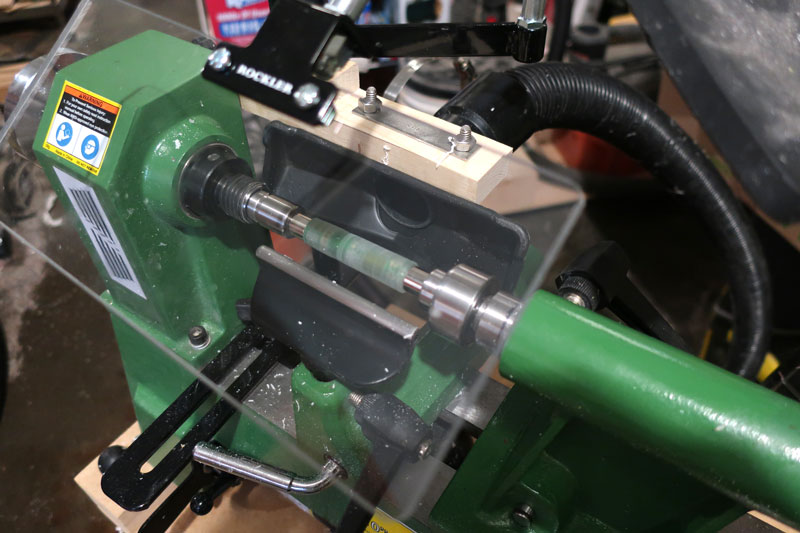

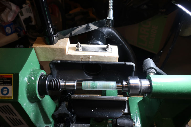

Several months ago, I purchased Rockler's Dust Right Lathe System . It worked pretty well with a full-sized pen mandrel, but with TBC it was way too large. So, a little pine, a tee nut and bolt, a U-bolt, and a 1-7/8 Vacuum nozzle later:
It collects a lot of the chips, and 99% of the shavings/ribbons/dust... :biggrin:
