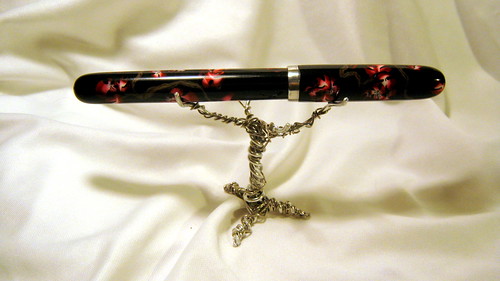

Most of the PC pens we've seen have been extremely colourful but this one seems to be even more vibrant with only the two (?) colours.:eek: Just like everyone else, I think it's stunning and is very capable of not needing a clip. A pen like that shouldn't be hidden in a pocket, it should be on display. Maybe a stand like they use for Samurai swords.:biggrin:
I don't disagree. It should be on a display over my fireplace! :biggrin:

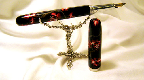

Jeff I was experimenting with a similar technique on another pen. The problem I run into is the clay has to be built on the the pen and fully finished before adding the clip. If I made the slot in the metal before it was covered I would lose it. Then I thought about making a special piece to fit in the slot and leaving it in while I was wrapping and rolling (sounds fun eh'). The problem was during finishing I CA'd the piece in and pretty much destroyed the clay around the hole trying to get it in. I may try and make the slit after finishing the pen, but I have been hesitant knowing I may destroy the piece and all the work that went into it.
I noticed a company by the name of Yard-O-Led (Art Brown Catalog) attaches a clip with two small rivet/screws from the outside. I may have to give this a try as well, but I don't want the rivets or screws to be a distraction or eye-soar.

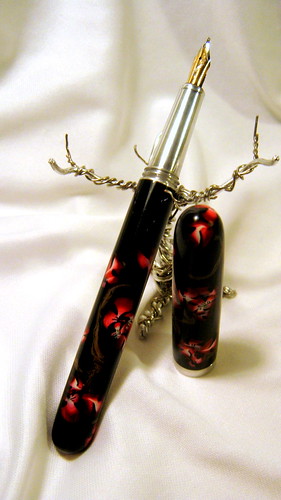

I promised some members a closer look at the details. The pictures I took are much larger then I posted, but I didn't want to throw anybody off by posting a huge picture of a pen.

Philly thanks for the imput:smile:. My intention was only to have the know-how when or if I want to add a clip to this style of pen. For this specific pen I didn't want a clip. My dilema was trying to figure out how to add a clip to this style of pen if one was requested by a customer. I am a newbie when it comes to kitless so my general knowledge of clips and components is much lower then other members on the site:bulgy-eyes:!
K
try using UHMD or Delrin for the fill piece. CA won't stick to it.
Keith thanks for clarifying the issue now I can see what you are looking for. Perhaps for a newbie i sure put my foot in my mouth. huh?
BTW, i was wondering about the process, as how youdid the whole thing or is that a kit?
Philly, there is no kit. The body and nib sections start as a 1/2" aluminum rod, drilled, turned and threaded on the lathe. I turned the body so it is the same shape as the clay that covers it. The cap I start with 5/8 stock. The center band is the highest part and from there I knock it down to make room for the clay. The overall thickness of the polymer is around an 1/8" or so. I apply the branches and the cane slices and roll it smooth. It is very easy to shape with the core inside. After that everything is baked, wet sanded, and CA'd.
