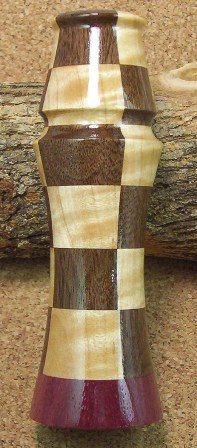

armyturner Member Joined Sep 1, 2006 Messages 425 Location Oil Trough, AR, USA. Jan 6, 2008 #1 Here is a predator call that I just finished. It is about a weeks worth of cutting and glueing. Woods are maple, walnut, and purpleheart.
winpooh498 Member Joined Apr 23, 2007 Messages 808 Location Junction City, Oregon, USA. Jan 6, 2008 #2 That is a very nice looking call! What do you use for a finish?

armyturner Member Joined Sep 1, 2006 Messages 425 Location Oil Trough, AR, USA. Jan 6, 2008 #6 The finish is dipped using Helmsmans spar varnish thinned 50% with mineral spirits. It has 4 coats. I like to dip these in order to seal the inside as well as the outside.
