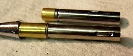

Man, someone must have put a curse on me.[V] I've never had a problem with trannies or other bits.........until now.
I was busy assembling my latest pen this morning and didn't even think to check the tranny. The bum one is fitted and there is a loose one for comparison. Spot the difference.
<br />
the shiney sleeve is not crimped on and the damn thing ( the sleeve ) got stuck in the tip twist pen. I got it out and just crimped around it with side cutters. The grease was holding it together, which is why I didn't notice.
