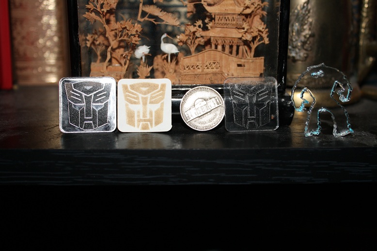

The question often comes up regarding the quality of the cheap Chinese laser cutters. I seem to be the only proponent of them, but given where the one I use is located, I have not been able to provide any real documentation on them.
I had some after hours access this week and thought I would make a couple of quick things to demonstrate their capabilities.
These were made on a $3000 machine with a 13"x24" table. This machine has been in use for about 2 years. The only maintenance that has been done on it has been 3 alignments on the mirrors, each after moving the system.
The autobots are done on paper, a piece of mirror, and a piece of 1/8" extruded acrylic. The space invader is a piece on 1/4" extruded acrylic. All of these were done in a single pass.
As far as speed, the autobot takes about 70 seconds to engrave and cut. The space invader takes about 20 seconds.
The software is less user friendly than a quality American system (Epilog, Universal, etc.), but it is also an order of magnitude cheaper.

The hardware is of impressively high quality. The electronics are good as well.
The mirror mounts are poorly designed, but 3 pen springs and 5 minutes fixes that. The software is weird and stupid, but fully functional.
They don't sell a rotary mount for these, but the system is just a set of stepper motors, so it would be fairly easy to swap one axis for a rotary one if you were mechanically inclined.
I did pay the extra fee to get it from a US distributor that I could call and hassle if necessary, but it still came in under $3k and I have not had any issues at all. I keep expecting to have to overhaul it, but it just keeps on chugging.
I cut aluminized mylar, paracloth, various woods, obviously acrylic and paper. The thickest thing I have cut in a single pass is 3/8" oak.
