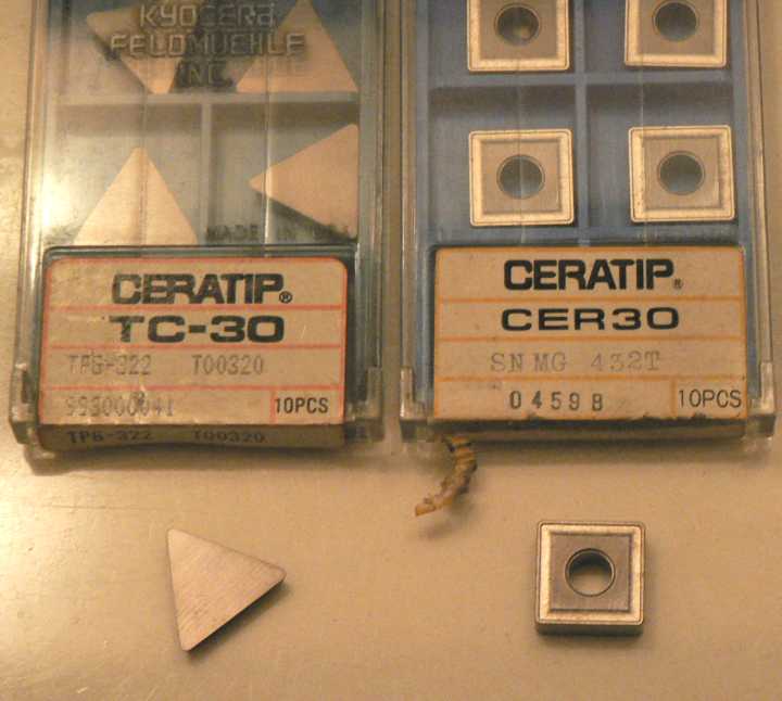

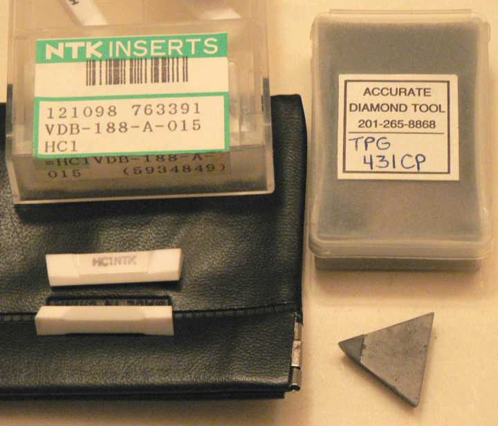

Will any of these ceramic tip inserts work for woodworking tools?
Pictured are:
NTK Inserts 121098 763391 HC1 VDB-188-A-015 (elongated whiote - I have 10 of these)
TPG 431CP (triangular shaped- I have 2 of this)
Kyocera CERATIP SN MG 4332T 0459B (square w/ hole - I have 60+ of these)
Kyocera CERATIP TPG-322 T00320 993000041 (triangular - I have 9 pcs)
These are all new...any ideas what these are worth (if any)?
Thank you :)
Dario: I'm willing to try some! Ceramic should hold an edge for a long, long, long time... These must have been used to machine some gnarly stuff.. They look a bit like carbide to me, though, do they feel different from carbide? The square ones look like carbide with a coating or something, and the big triangles are clearly tipped.

The inserts from Accurate Diamond Tool look like they are diamond tipped. We use those types of inserts for cuting hardened steel inserts. I really like those. We have some black ceramic inserts that look like the NTK white inserts that we use for cutting parts off with.
All of these type of tools take special holders that can cost some money but what doesnt anymore.
Have never tried them on wood before but i figure you can get a long life from them. You can touch up the diamond tipped inserts a few times but we use diamond wheels on our grinders for that.
The ceramic we generally toss once they lose their edges. You can resharpen them a bit if you like but we dont usually. Ceramic inserts can be chipped pretty easily too.

Here is a link to a reference chart that will tell you the designations on the inserts such as the TPG-322 and SNMG-432T.
http://www.carbidedepot.com/formulas-insert-d.htm

Dario, I wouldn't think that these would work right out of the box. They do not have a sharp edge. They are good for hardened steel. I have a couple of styles here at the shop and may try to touch the edge on the grinder and see if it might work that way.

Thanks for the info, please do check if it won't cause too much trouble.. You think the diamond tipped one can be honed with a diamond hone?
Another question on the diamond tipped...can I reshape the triangle (other edges since only one edge is dia tipped) and turn it into a slighly thinner/longer shape using a regular grinder?

Couldnt find anything in our catalogs with those numbers. I wonder if these are discontinued or just not in the books we order from. Heck i even looked on ebay and i didnt find them there. They have to be somewhere right??
You can hone the diamond tips but be careful as they are pretty fragile. Not sure how well a regular grinder will grind the other sides of the triangle as they are probably carbide like the ones we use. Again we use diamond wheels for that.
You dont want to heat the insert up too much as the diamond tip might break loose. Take your time and keep it cool with frequent dippings in water. It may work ok for you. Sorry i couldnt be more helpful.
