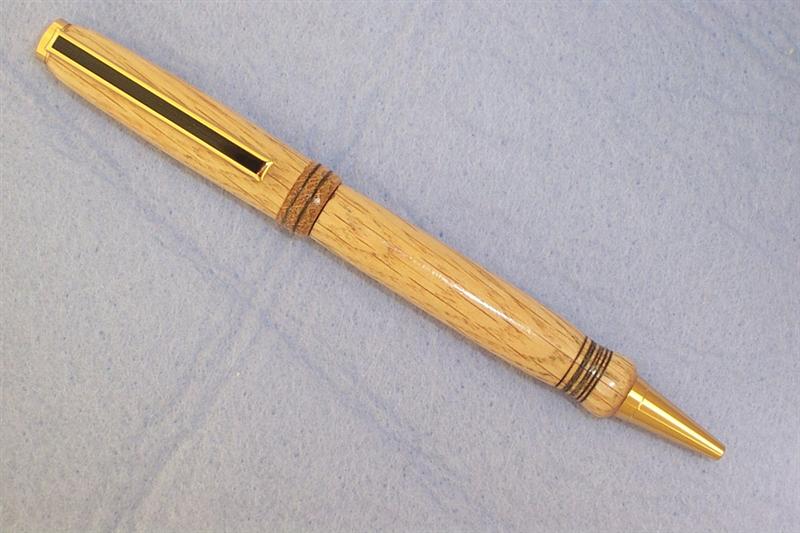

Another thing to try,but it works best if part down to the tube and glue it on.
Either save cuts from acrylic blanks(or any other for that matter)
Mill one end after drilling,glue on to the parted off section of the tube.
cut off remaining section leaving enough room to mill again.
I usually do this on CC's but have also done it with antler and cross grain woods.
This was the"lowly slimline" CB is a piece of the trimmed blank cut cross grain and glued on.
