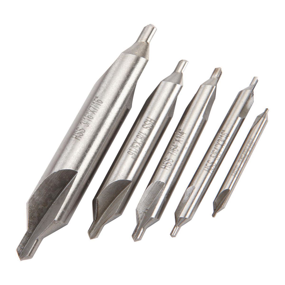

I drill on the lathe only. Best advice I can give you and wish I had known about them sooner, is the get a set of stubby center finding bits. Got mine at Harbor Freight and they are good enough. I have not had an off center hole in over a year. Another thing to look into in solving this is simply make sure your blanks are good and square to start with. As pointed out already, it's not so important until you get into segmenting. It's better to instill good habits from the get go, than to break bad habits in the future. I'm not a big fan of brad point bits either, they are not the best for end grain drilling.
Ken, are you talking about the hinge bits that are used to center the pilot hole? I've had my share of off center holes, so I'd certainly give them a try.

for interest you can get long series centre drills which would go all the way through if lifted clear VERY frequently to clear the chips . Available over here from MCS They are very rigid and go where you point them.
