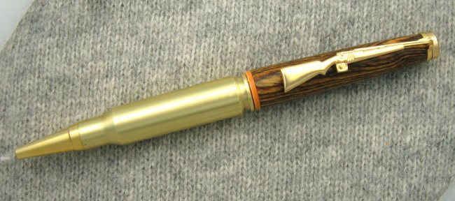

Eagle, I've been thinking about this long enough to have saved up a couple of hundred different colored soda caps. Here's one I did as an experiment. I cleaned it up a bit after taking the photo, but sold it before I could get another pic of it. The plastic doesn't finish very well. (too soft?) Thought about laminating different colors, but haven't had a chance to do another one yet.
