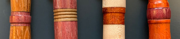

Custom center bands are fun to make but even more delightful when salvaged from scraps.

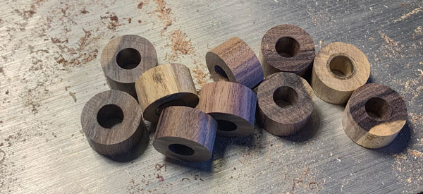

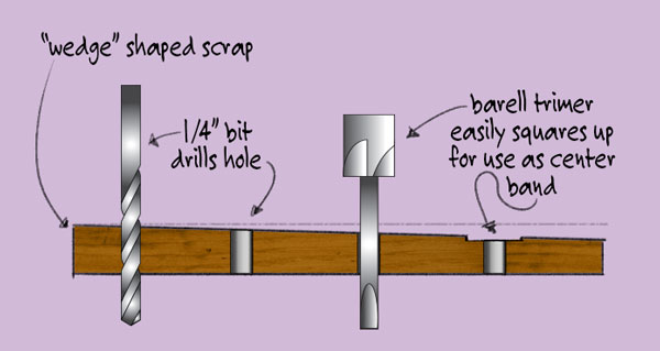

My scraps are often leftover boards with damaged endgrain that needs to be leveled and cleaned up.
My Solution
(Not rocket surgery, just how I do it.)
Instead of setting up my planer I keep things ridiculously simple by using a barrel trimmer.
This levels the offending side and ensures the top and bottom are parallel.

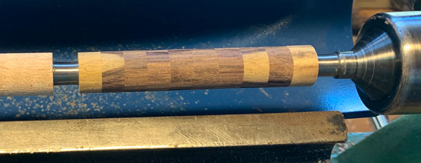

Thrown on the lathe and rounded these roughed bands are great to have on hand.
Alternate
By stacking pieces you might be able to eke out one last segmented pen from a favorite board of good wood.
