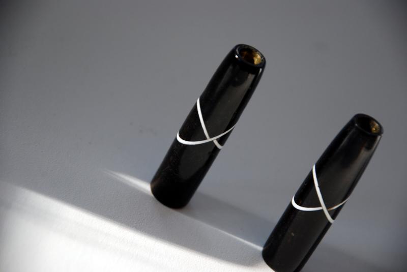

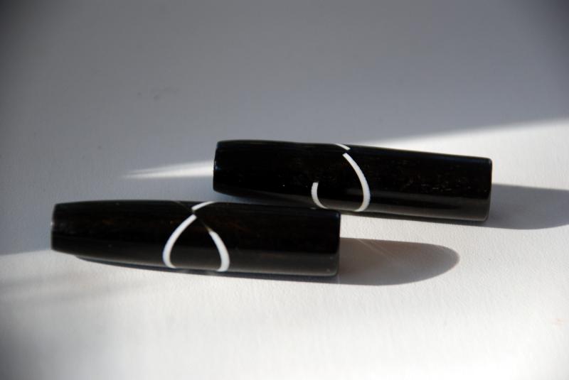

Well my first attempt at a knott failed. Ivory and Ebony but how the heck to you get those lines to match up????

Its all about the glue up
If you are cutting all the way through your blank you need to put the pieces back in the same order and perfectly in line. Some people just cut enough so that there is about an 1/8" piece of material left. Then when they slide the inlay material in it just fits tightly and clamp it. The aligning part is done for you then. The catch with this system is you need to be very precise with the inlay material matching the thicknes of the kerf the saw blade cuts. There are articles in the library explaining this. Also there are videos on utube that explain it well also.

Regardless of technique used to assemble, thickness of the inlay must match that of the kerf or the lines won't match up. The reason being is that when you make that first cut, you'll be fine regardless of thickness., but the second cut, if the inlay doesn't match the kerf, it will move the first cut out of alignment.
The above answers are right... The short and simple answer is that your inlays must match the thickness of your blade.
I had the same problem on my first celtic knot - it was supposed to be a bottle stopper. I couldn't stand the thought of throwing it away, so it's not a fob on my key ring.
The error in the first cut is equal to the difference between the width of the saw kerf and the thickness of the inlay, divided by the sine of the angle of the cut. And the error accumulates with each additional cut.
So you must make the thickness of the inlay exactly match the width of the saw kerf.
1. To make everything easier use an oversized blank (longer and thicker)
2. Do not cut all the way through the blank but be sure you cut to within 1/8" from the end.
3. Be sure your inlay material (plus glue) completely fills the cut without expanding it.
4. Practice on scrap material.

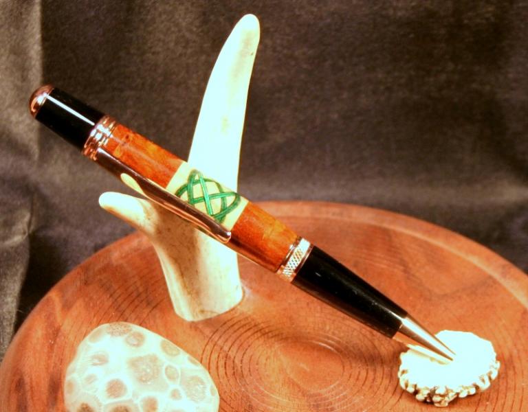

This one took me three tries and it still isn't perfect:
Thank you,
I noticed the deer pedicle that your pen rested on, in the photo. I have been saving them as I cut antler. I am not sure what to do with them except to make pendants. What do you do with yours?

I see. I will now try to cut without going through and then fill the voids. Whoda thunk??

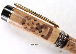

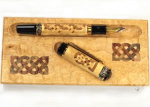

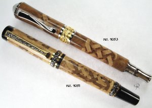

Hi John,
Glad to see you got the harlequin knot to work. Haven't heard from you since those days on Penturner's Paradise. Did you ever try the "Stained Glass Windows" knot I suggested. Should be easy now with all the great acrylics available.

I see you posted your latest creation and still marvel at the workmanship behind these. This is taking knot making to the next level. Thanks for showing and saying HI.
