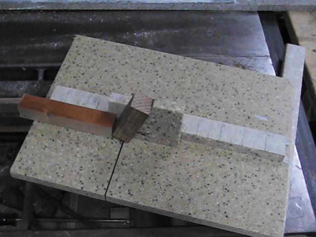

PIC_0066.jpgMade with my jigs on the band saw.
Step by step pics. Let me know if you have questions

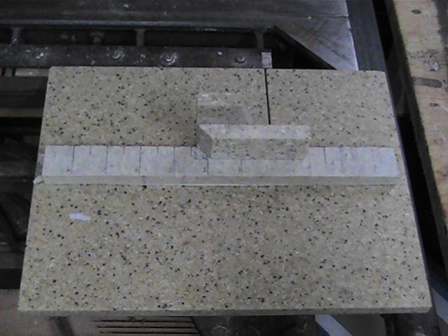

PIC_0068.jpgFor straight cuts

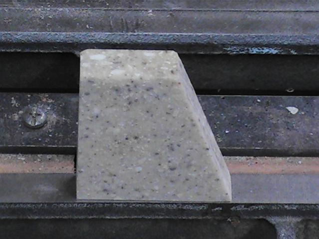

PIC_0069.jpgAdded support for blank, its cut at 70 degrees.
PIC_0070.jpgBack support for blank

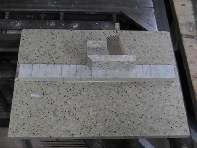

PIC_0071.jpgBlank on jig
PIC_0072.jpgStock added to help support blank
PIC_0073.jpgfront with blank in place

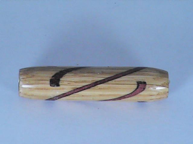

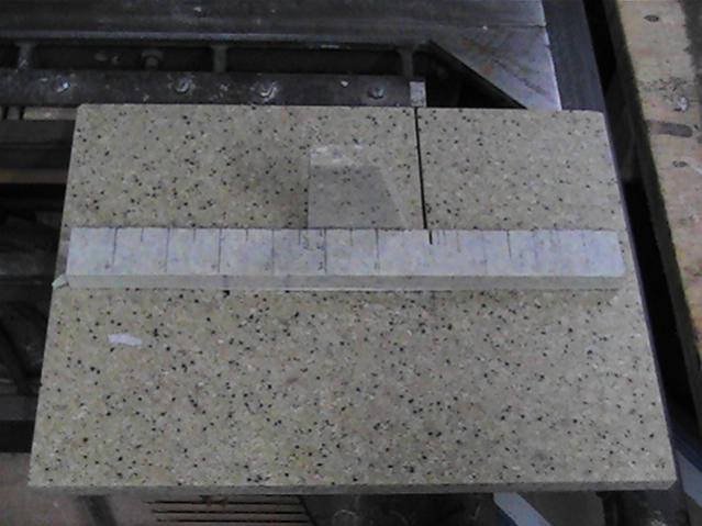

PIC_0074.jpgblank removed, this jig gives the kerf for the top part of my pen. Only cut half way into the blank on all 4 sides and filled with purpleheart

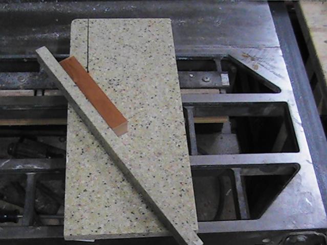

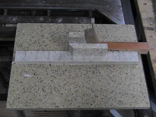

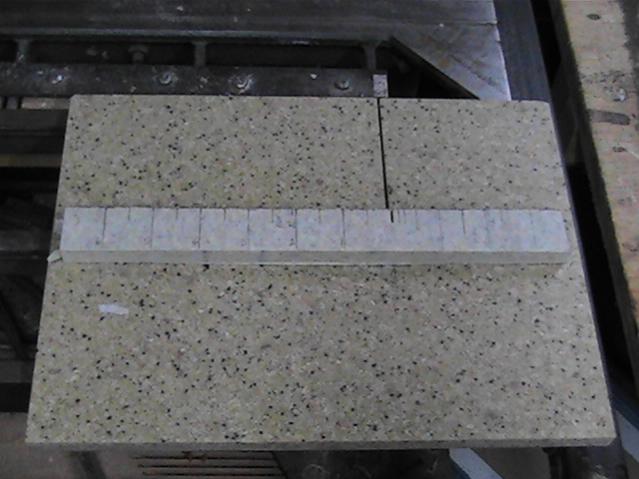

PIC_0078.jpgAngle cut at 70 degrees, can be changed to any angle desired

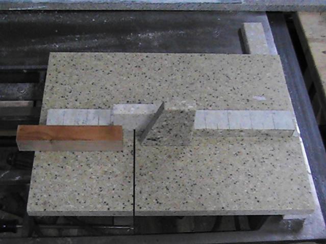

PIC_0075.jpgFor cutting kerf for cross at 55 degrees. I cut all but about 1/32 into the blank.
Only parts attached to jigs are the fences and miter slot runner on the bottom, all other parts are clamped in place.

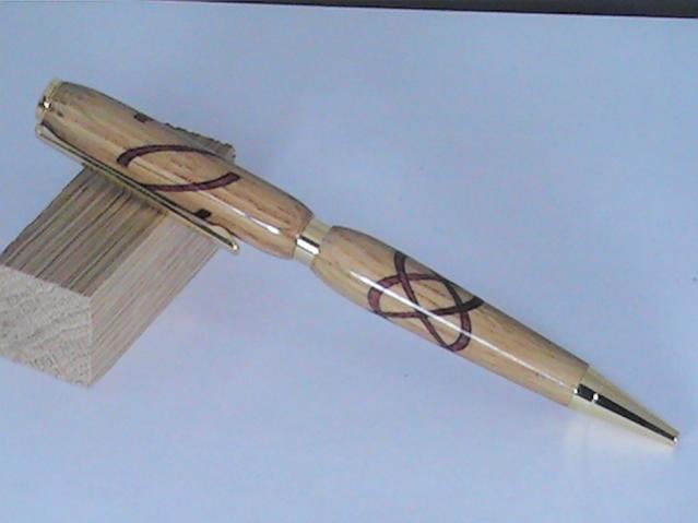

A different effect
Bruce,
I can get a longer inlay and it seems easier to cut the kerf, feels safer too. Dont think you can cut from corner to corner in the other jig. Or am I just not seeing it right??? I will investigate further....

Bruce,
I think Rick nailed it for the feather look. The blank needs to be cut at 90deg to the blade and only cut about 1/2 way through. I've contemplated it and could only think of tilting the table 60deg. Bye the Bye....good looking pen.
Good,
:confused:Thought I was losing touch with reality for a moment there................but I did fudge the angles a bit. One is 70 and the other is 55, I corrected that on the pics.
