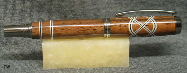

Hey Tom -- got the e-mail from one of the mags - one of the gallery pictures was rolling pins made with the celtic knot -- with the insets about 3/8 inch --
the rolling pins were a nice job and regardless of size -- what goes out is the same thickness as what goes in. Just plan for the thickness desired.
Wow, I have not seen those pens. They are awesome! So is the animation!
Is there a library entry that explains how to insert the different colors?
Ok, how did you make that animation?
Animation is done using photoshop
No secret with the colors. I shown these quite awhile ago. Here is a photo of the blanks so that should explain the colors. Hope this helps and good luck with the knots. They are fun to make in any style pen.
