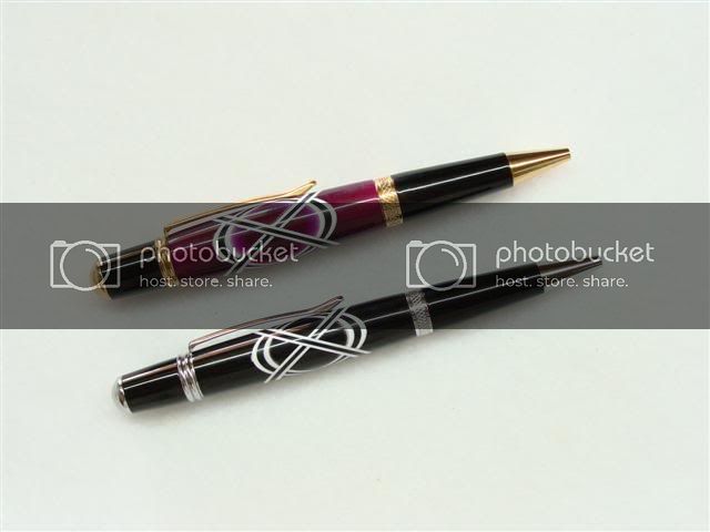

I finally got some time in my shop this afternoon and made these two right from scratch.
I believe I am catching on how to make these Celtic knots quite a bit faster and with much better accuracy than my earlier ones.
I could show pictures of them from all sides and the knots are equal and symmetrical all around.
I had bought these solid color acrylic blanks some time ago with the idea of using them for this purpose.
A friend sent me some triple layer pick guard material and I wanted to try it out. .
I know some are going to say it has to be wood and I also love wood but in my area acrylics are about equal for sales as wood is. Ones that are not using acrylics as well as wood could very well be missing out on some good sales. .
As long as it is not wild pattern acrylics that distract from the knot I believe these solid color ones will be as well accepted as my wood ones. .
The top wine colored one is a Sierra Vista and the black one is a regular Vista. Both are basically the same kit except for the Vista is a larger diameter which has the ability to show off the knot a little better.

They are gorgeous!!
OF course I speak "from the darkside", but plastics WILL outsell wood, if you give them equal space and you don't let YOUR prejudices come through.
AND plastic is MUCH EASIER to finish.
Give it a chance and you will be making more!!
You're already GOOD at it!

Here are the same pens with a quarter turn.
Reaqlly good looking Sierras Great work with the pickguard material! One of these days I'm going to start doing something with my PG sheets.

Outstanding job! Both are great. I really like the shading differences and color of the wine one.
Some of that is just photography the way the light shines on it .
I got the jet black blanks and the purple (wine colored ) and a couple dark green ones . I have not tried a green one yet but should look cool .
I asked for darkest color with the least pattern possible so as to not distract from the focal point which is the knot .
The black ones are solid jet black and the others have a very slight amount of pattern to them.
I am keeping the black one in my own pocket for now until someone likes it more than I do

I really like those pens. The knots look excellent and display well with the solid color acryllics. I think the contrast with the purple is especially striking.
I still have not done acryllic, but the more I see of them, the better I like them.
I had two black and two maroon and two blue blanks that I had ordered as close to solid colors as possible according to the distributor I ordered them from . The black is jet black so no problem there and as seen at the start of this thread the maroon one was not a solid color and neither is this blue one that I made this afternoon. . I have been trying one each of those blanks . I will be looking on some sites for various colors that are solid with no pattern for some future ones. The maroon and blue don't take away a LOT from the knot but I think solid colors like the black shows off the knot better. . That is probably why I am keeping the black one for myself for now until someone wants it more than I do.
I don't normally time my projects in the shop but this time I did just for an idea of how much time to figure into a whole pen or if I were to sell a few blanks without the hardware on them .
This one took exactly two hours from the raw square blank through to the installation of the hardware. I was not hurrying at all. Just puttering away at my normal speed .
Keep in mind that I have made quite a few Celtic knot pens and it took quite a few to learn enough little tricks and shortcuts to be able to reduce my time to this. I think my first ones took at least 4 hours to make.
