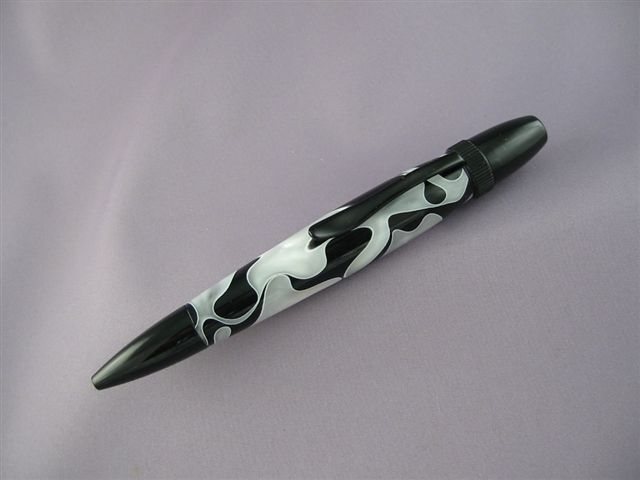

<br />I have turned a lot of CSUSA celluloid's. When I am using these blanks I paint all my tubes with Krylon black, I find these blanks have a transparent depth that allows you to see the radiance of the tube...using black painted tubes actually ads density to the colours in the celluloid.
This is a Junior Gentleman's ball point pen. I painted the tube in this pen black. It added the look that made this pen the happy choice for a customer of mine at a craft show.

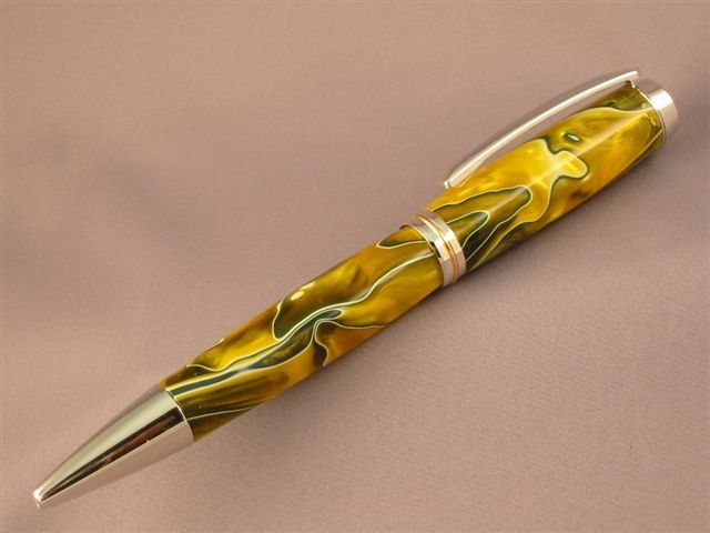

This is another celluloid on a Patriot, again the tube painted black.
