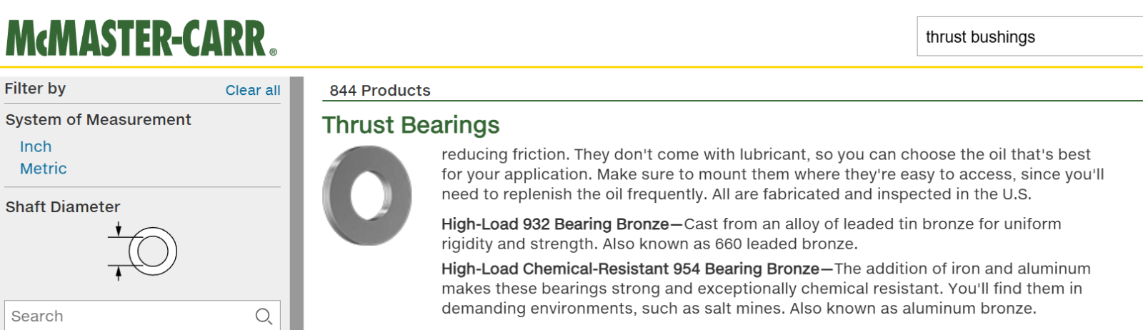

I use Thrust Bearings from McMaster Carr for spacers. I bought the I.D. to fit my spindles and then a few various widths.
