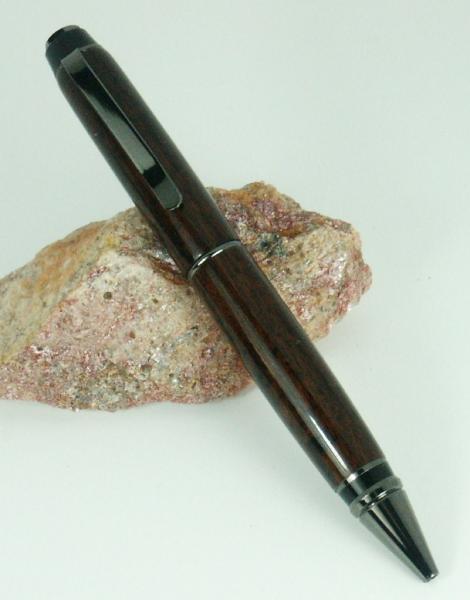

Atherton Pens Member Joined Sep 27, 2010 Messages 307 Location Powder Springs, GA Feb 14, 2011 #1 This may become my new "favorite". I like the clean lines, weight and balance. Just MHO... Mesquite (I think) + BLO/CA + MM to 12K + Polish and Gun metal components. Comments and critique welcome. Attachments CB-less Cigar.jpg 25.3 KB · Views: 316

arioux Member Joined Jan 20, 2005 Messages 1,733 Location Terrebonne, Quebec, Canada. Feb 14, 2011 #2 Love the look of it. Nice modification. My guess is that you replace the top 10mm tube by a longer one. I'll have to try this.

Atherton Pens Member Joined Sep 27, 2010 Messages 307 Location Powder Springs, GA Feb 14, 2011 #4 arioux said: Love the look of it. Nice modification. My guess is that you replace the top 10mm tube by a longer one. I'll have to try this. Click to expand... Yes, it's a very simple modification. Use a longer top tube and match the top and bottom to coupling ring.
