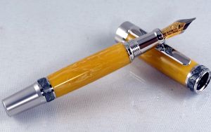

Thanks to Gary Max for the blank! I've added the explanation of Catalin below.

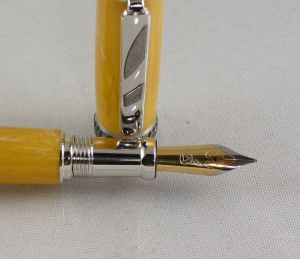

Just for MLK A close up of Lou's Nib not Nip:biggrin:
Ed, I was warned that it would crack during drilling so I glued a waste block on the bottom and slowed my DP to 250 RPM did not drill all the way through (but you know that). Sharpen the bit on the Drill Dr. if you have one. DO NOT cut it off on the table saw use the band saw DAMHIKT. Drill only 1/8th inch at a time and spray water in the hole (PITA) but it worked for me, the waste block was used in case I went to deep as both blanks were cut just 1/4 long.

How did you drill it? I have had cracking problems, while drilling.

The nib leaves a lot to be desired, but the pen looks fantastic.
Mike
Hi, what do you mean the nib leaves a lot to be desired ? I am about to do a few of these pens for the 1st time. Big investment for me and i want to do them justice. I think the pen looks perfect.

Unlike the bakelite, that catalin is pretty translucent stuff. You did a great job on not having the tube show! (BTW, if you want some more let me know :biggrin:.)
Carl, MLK was giving Roy a bad time. Roy almost always dresses his fountain pens in an upgrade Heritance nib. Especially in the higher end kits.
If you are interested check out Lou's (DCBluesman) listing in the Most Valued Vendors Form.:smile:
Princess, thanks for coming to my defense yes the nib leaves much to be desired and will be changed, damn that Mike he always catches my screw ups. A Heritance F/S nib will be on it before the days out. Also be sure to paint the tubs on Catalin,as Printcess said they are very translucent.
