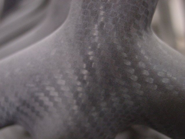

I've got a new one here. I've read some of the threads pertaining snake skin pens and I'm a little confused as to the best way of making these pens.
I work for a bicycle maker and I've got my hands on some of the carbon fiber they use in their high end ($7000) bikes. It's very thin material and come in a cool weave look. I've attached a few pictures on how it looks on a bike and I think this will make for a very interesting look on the pen...but here is my problem. I don't know how to do it.
I think turning down a piece of wood undersized, glueing the fiber onto it, slobbering on CA glue and then finishing sounds like a pain in the butt.
It seems the article "Cast Resin Blanks" is more my speed. Please let me know if I'm heading in the right direction

Sounds like a plan! :) You could try glueing the composite to the brass tube, then casting it in resin, or you could try to simply shape the composite into the size and shape of the pen barrel.

Hi Chad, based on my experience with it, I don't think that will get very good results. As you can probably see at Trek, they get the raw graphite cloth and cover it with some nylon and heat it all up in a metal mold with an expanding bladder in the middle. I would think the slobbering of CA method would be a good second to doing it with a heated mold. I tried overmolding a wood pen with polyester and could never get it to set properly no matter how much catalyst I added. I tried with CA and got good results.

Casting in PR would be the way to go. I've glued numerous things to the brass tubes and cast the tubes in resin with great success. Don't know about the fabric you think about using, but if it fails you've loss very little. The resin is cheap if purchased correctly (not a michaels or Hobby lobby)... 30 cents per pen ... sounds like you got the fabric for free....I have not tried the CA method since I get good results with PR. Wood like lacewood turned to the size of a slimline and cast in PR makes a nice pen. The curved surface of the PR and its clarity makes the lacewood pattern really magnify and look nice as it does with the snake skin. Was the article you read the one by Jay Pickens? If so, you are 85% there. He has another article about embedding things in the casting and maybe we can get it posted to the IAP site. I'm working on it.

I was looking at a different article but in reading Jay's article that looks like it'll work also. My process steps will be to glue the fiber to the brass tubes and, now the part I don't quite understand, is somehow casting the clear resin around this tube. How viscous is this stuff? Do I put a bar through the brass tubes that: 1.Plug the brass tube and 2.The bar will create a guide hole for the drill and pen mill?
Not real sure on how to embed something in resin so any help would be appreciated.

Chad, I would cast your blank in a flat mold, the sucker will want to float around, so be sure to anker it somehow. I use potatoes, basewax and toothpicks to keep them from floating in a flat mold.
You can also cast in a piece of PVC, but you will have to make a plug to keep it centered and keep it from floating. If you do it in PVC tubing, let it set for a couple days, no need to use a release agent, as it will shink and come out. Good luck.
