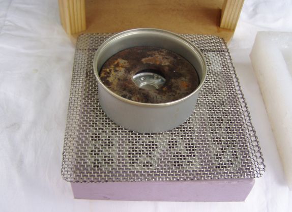

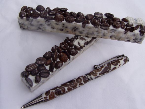

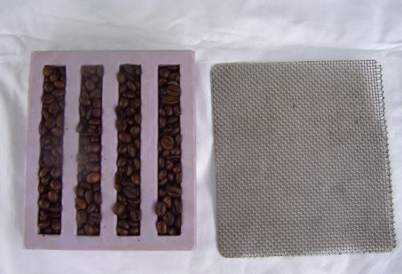

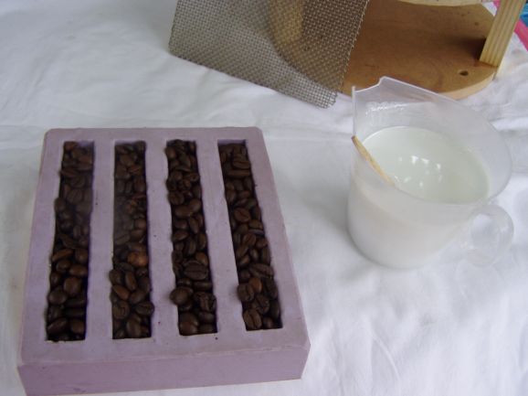

Here's some photos to show you how I did my casting ,
What you need is :
Coffee Beans ( I think so :biggrin: )
Resin or Alumine ( I prefer resin )
Casting mould ( look at Gadget one of our member for mould casting )
S/Steel mesh and weight
Jam pack the mould cavity with coffee beans pour your casting, top with the S/Steel mesh and weight pressure at 65 PSI
Happy Casting

Hey Serge,
Does your wife know you use one of her "pound" cakes for a weight? Great idea! Thanks for showing us. Your bean casts are really nice looking.

Jason I do use a HF paint pot for my casting under 65 PSI .
I forgot to say that only 5 ounces of casting is enough for the whole mould ( at least for me )

Without a pot, you will almost certainly end up with tiny bubbles that will want to stick to the beans. This will result in one of two bad ends; either your final pen will have ugly bubbles in it or (more likely) the blank will explode while you are turning it.

OK, dumb question...where did you find the mesh? I wonder if I could use window screen material, as I'm not sure when I'd stumble across some SS mesh!

If I understand correctly, its just to hold the beans down and not allow the weights to stick to the blanks.. you prob could use parchment paper or something else to help keep your weights from sticking.

Dale my piece of S/Steel mesh is from an off cut from security door, the wire is an heavy one ( I mean a thick one ) window screen material is to soft and will stick to the PR, The aim is to OVER fill the mold with coffee bean, like that the mesh doesn't touch the PR when pressurised and curring, if you can't come across some S/S try to find some very small chiken mesh to prevent the coffee bean to go through it .

Now forgot to say, do 2 pressures in your pot,
when you fill your coffee beans with PR pressure first time at 65 PSI leave for few seconds then release the pressure take the blanks mold out of the pot, top up the blanks with the remain of the PR then pressure again at 65 PSI
why?
I find out that when you pressure the first time the PR goes into the small coffee beans crevasses ( or cracks ) and diminish the size of your blanks and they are not at the right size
It's just 'plastic' that nothing sticks to. It's a good idea, but I don't see it separating the excess resin from the beans as well as a type of screen would.
No seperating of resine here, the screen or plate of any kind is to weight down the coffee beans when the PR are pour over the beans this plate or screen is to prevent the beans to float while casting
You might try the screen mesh that comes in a sheetrock repair kit.. it's actually aluminum I think, but seems stiff enough to hold the weight. You can find them at the big box stores.

Dale you will need thin CA, when cutting the blank cut it 1/8 more for the lenght drill it them soaked with thin CA ( coffee bean are porous ) when I glue the tube in I usualy soak the end of the blank with CA before sanding them to size then I soak again before I set the blank(s) on the lathe keep CA next to you as well as accelerator, let us know how you're going

Do you square up your blank ends with a pen mill or sander ?
Either way you want but if you use the pen mill make sure is sharp and go slowly don't forget coffee bean as been roasted so it's very friable than the PR or Alumine, I did use 4 and 6 cuter mill head and I didn't see any difference
