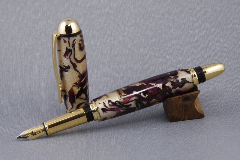

yes, JayDevin did it a while ago. He made a dozen blanks or so and, to my knowledge, I And Draken were the only two to successfully complete pens.
here is mine:
pretty, but tough to do. The petals tended to separate which let the blank blow apart.
