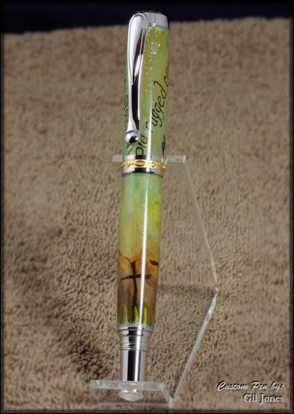

I've done a few and I'm not coating them with anything. I think my wife's paint is water based...I'd have to check...this was my first one.
Gil
I'll add a couple more of my experiences since I just started this as well. I tried to follow the advice of several others saying they are using a jewelry cleaner to heat up and thin the resin and help remove air bubbles. Well I ended up hating that idea. Maybe it's because I'm already in a warmer environment but I could see no visible thinning of the resin and all the vibration did was introduce additional air bubbles that seemed impossible to remove. Also it seemed like the act of heating the resin caused it to start to cure faster when the hardening drops are added which gave me less time to work any air bubbles away from the tubes. I'm actually going to consider coating my tubes with CA but not for the purpose of preventing the paint from leeching but because if I'm using a toothpick or something similar to push air bubbles away from the tube I found the slightest touch on the tube could leave a mark.
So I found the jewelry cleaner to be very dangerous. It produces more air bubbles than I started with and after smearing an "O" in my wife's lettering trying to push the bubbles away I got slapped up side the head. :)
Gil
