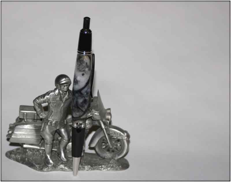

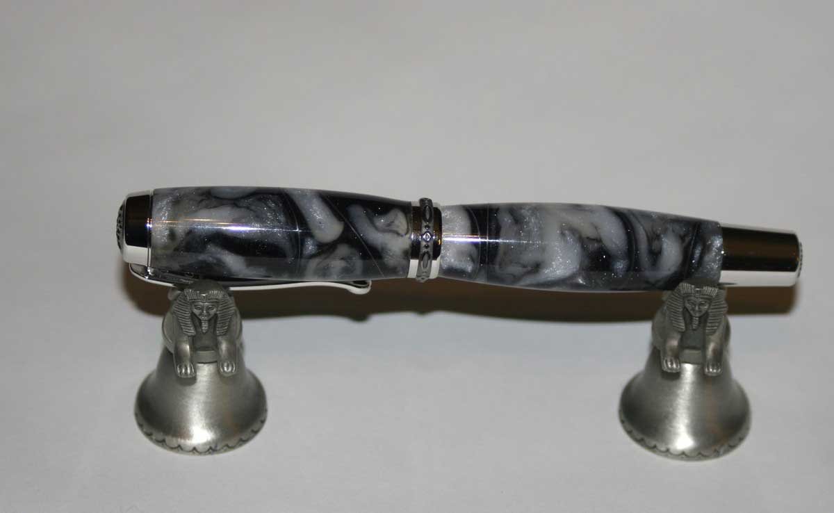

I finished this Jr Statesman II with a special mix from the garage.

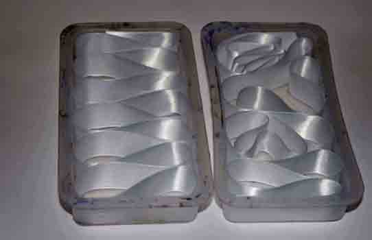

Please tell me more about the polyester ribbons and how you embedded them.They look good in there.
ones
Oct 20, 2007
79
stanford, il, USA.
I mixed half (4.5 oz) in black with a small amount of blue tint and super sparkle. The other half was pearl white. I mixed both batches at the same time. I layed out the ribbon in my mold, just any way it seemed to fall. Poured the black mixture first and let both stand for about 20 minutes. Then I poured in the white pearl and started dipping my stirring stick into the mixture. Not really stirring, more just drawing the 2 mixes together.

Could you give more info. on the ribbons? Did you make them, and if so, the process. Or did you buy ribbon like used on presents?

nice work, isn't that ribbon casting tutorial neat, I had just a wee bit of seperation when I tried it, the blank still came out, but not as good as yours, very nice experiment..
