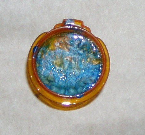

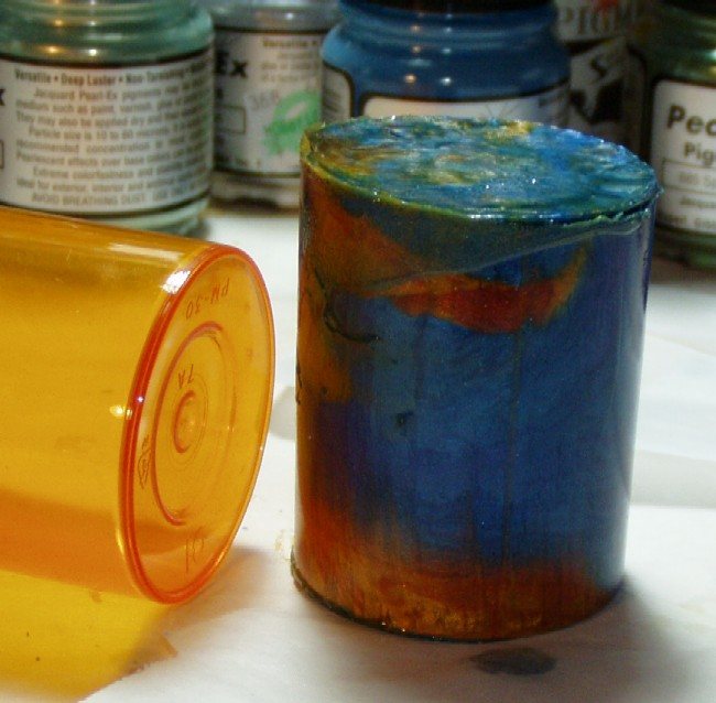

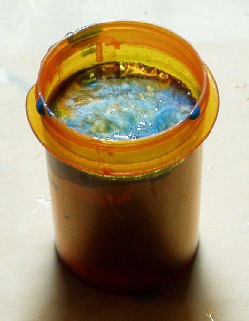

I need 1 3/4 inch PVC pipe, this was done with 1-1/2 and the Masonic emblem is a sterling piece I cast, I need to find the trick to casting the top layer, I cast the blue base, than added about 1/8th in clear, placed it in my vacuum bell jar for 15 min, then in the toaster oven for 20 min, then placed the silver on the firm but sticky clear layer then filled the pipe/mold to the top vacuumed it , but not quite enough, I have some very tiny air bubbles at the separation line right on the outside edge, fortunately they don't show unless you look for them, mostly what's showing is glare from my less than perfect lighting system [B)][B)][B)][B)][B)][B)]
