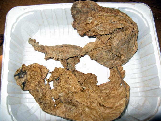

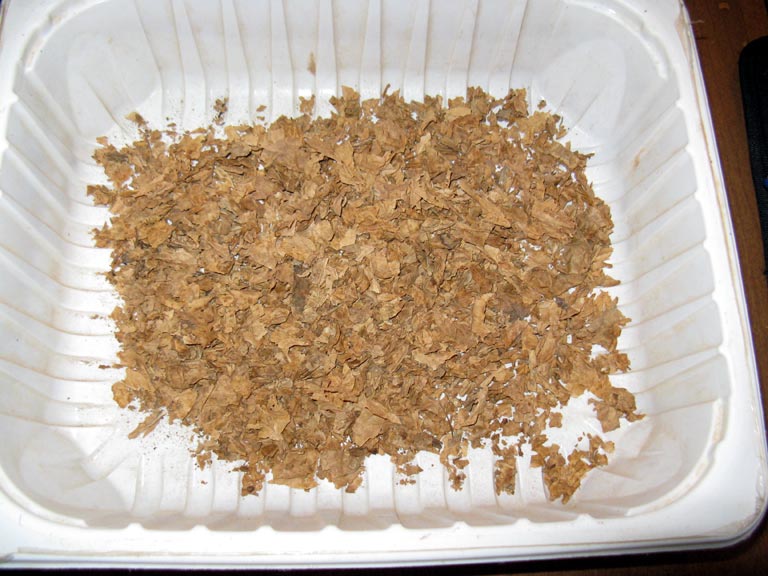

They grow a bunch of tobacco here in KY----how about just using the whole leaf.
I have never done this--- but it will work.
We could do some trading----toss Riley a extra mikebone for me.
Here's what real Tobacco looks like after it's dried.
Cut the dry leaves up and you are ready to cast them.

Hey Gary,
That might just be worth a try. Somehow my mental picture was of a deeper amber or walnut color from seeing some cigar and pipe tabaccos. Maybe when set in PR the material would darken a little? Maybe not. Either way, I'd be willing to buy (or swap for) a couple sets big enough for cigar pens if you were interested and you can cast them in clear resin (like a shredded money blank).
