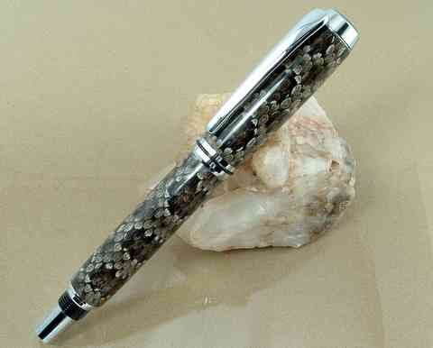

last week and this is the result of one. I hadn't cast snake for some time but when I got the new molds from Matt I decided to try again.Cast 3 barons and all came out as good as this one. I haven't turned the other 2 yet.As always coments good:D or bad:( welcome.
Sorry about the finger prints on the lower barrel, I just noticed them.
Yes,H/F paint pot @ 40lbs. for 30 min. before adding 3 drops per ounce MK and than add MK and for 4 hrs. @ 40lbs. Did not use vacuume as the vacumme pump would not work and still came out crystal clear.
Originally posted by johnnycnc
<br />Looks really good,Roy.
Do you cast under pressure?
Just curious.
Thanks for the info,Sir!
I do colored casts, no pressure or vacuum
but the clear is on my list of "to do someday".
I appreciate your help.[:)]
