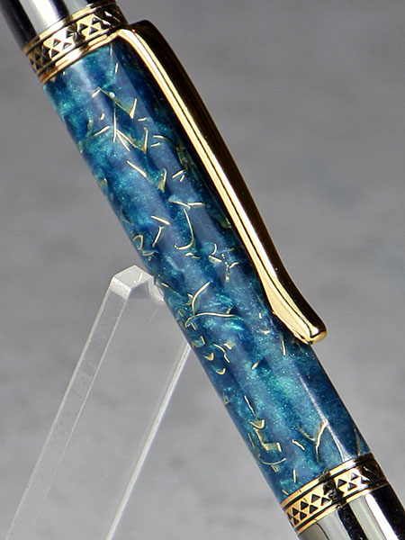

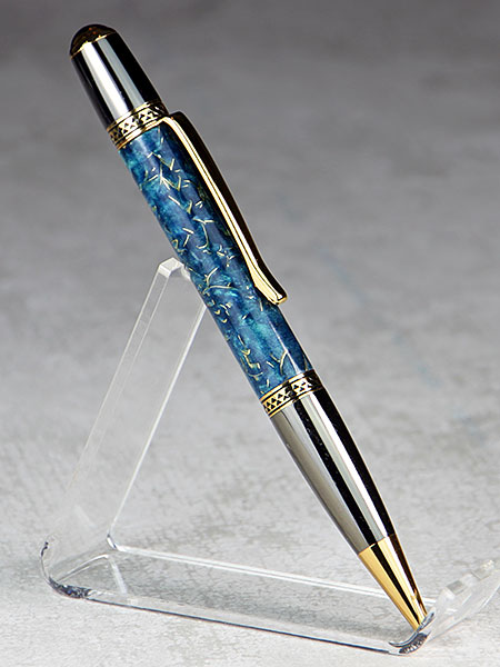

This pen was inspired by the Casting Contest. I entered a cigar pen made of Bordeaux resin and brass shavings that didn't win anything. I made this one later. It features brass shavings cast in PR colored with Blue/Green Duochrome mica powder on a TiGold 2-tone Tapa Pacifica kit.
attachment.php
attachment.php
It's an interesting effect, but probably not one I'll recreate again soon. The blank was challenging to turn. The brass pieces tendend to snag and pull out. I also had to put a CA finish over the blank to keep it from tarnishing. It is pretty in the right light, though.
I hope you enjoy it,
Eric

I really like this one! Great job on it and I don't think you should avoid this at all. Wish I could make blanks that pretty!
Gk
A very nice pen.
Who makes the Tapa Pacifica kit and where can it be bought from? Looks similar to Wallstreet I think.
The finishing of the blank is really good.
Ray
I really enjoyed the designs on your contest pen!

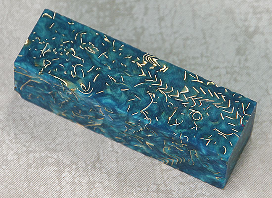

Thanks. Sometimes the brass can make interesting patterns if it happens to line up the right way. Spiral shavings in particular can look like acorn or fishbone designs. I just grabbed bunches of brass to make this blank - perhaps I should selectively use the spirals next time.

Don't do it Eric!!! The random look is great and I love this pen!! IMHO part of what makes casting fun is the randomness of it, no two are ever the same. You really nailed this one!
