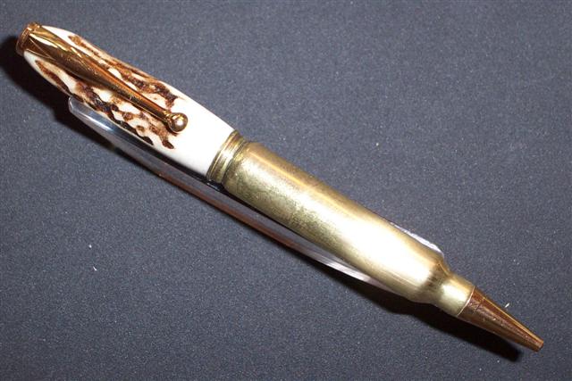

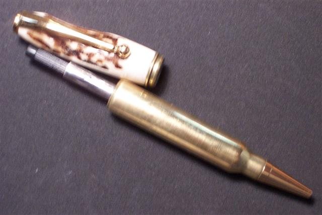

I found a bunch of casings I had drilled a long time ago.I remembered why I decided not to make a pen out of them.
I think they are 308's but not sure because they were drilled for a wood core.
I do know I had to trim a standard length tube from a slimline kit for the wood core as it was "proud" of the casing, the casing being just under 2" and the tubes are about 2&1/16.
I realized why I didn't use this caliber casing for a standard pen.
Even though the tubes are relatively close in length, the pen appears to be "top heavy"
This is a cute pen, might be nice for a lady.

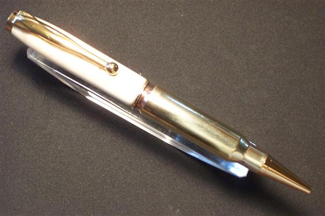

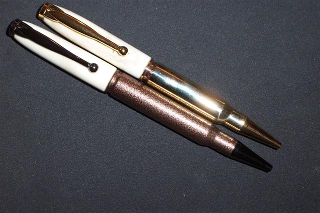

Here it is compared to a 30-06.I use Euro tubes so the pen has a "balance" to it.
Both casings are the same diameter but note the difference a little more length in the bottom makes.
overall length of the short pen is 5"
The more balanced 30-06 is almost 5&3/8ths
If anyone wants some short casings I have a few, I wouldn't bother to use them in the future.I aint even going to drill the rest out they are not worth it.
OPn second thought I may cut them shorter and make "longwoods" out of them.That's the beauty of the wood core, they can be "mosidfied"

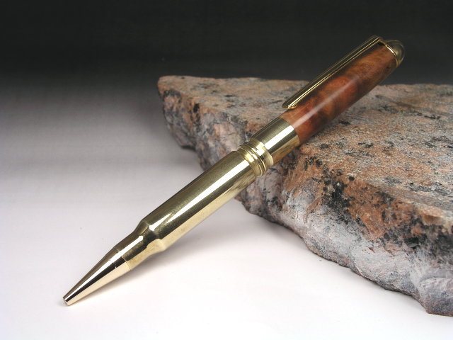

Here's an example similar to what you suggested only I used one casing and cut it even with the top of the wood core.I used the off cut for the CB.With the wood core and a tenon on the top section I get the same effect.
This is one of my first and still my favorite.
