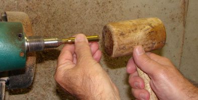

OK, has to be more than one way to skin a cat....er.... [;)] fit a brass cartridge to a nib. It occurred to me that brass is very malleable, that is why it is the material of choice for ammunition casings. So, without having to have specialized ammunition reloading tools, here is a simple way to make the mouth of a .308/30-06 casing fit a Euro, or any oversize nib. As can be seen in the picture, I held a case to the dead center on my lathe and tapped lightly with a mallet. I tapped once, measured, still too small, tapped again and it was perfect. A caution, putting too extreme a bell on the mouth will be ugly and could split the brass. This, of course, would have to be done before the tube and filler are installed in the brass. BTW, the amount of tapping/hammering on the dead center was very gentle, not nearly enough to be a concern for the lathe.
