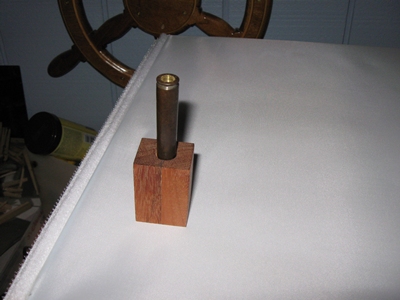

I just made a jig. Block of wood with a hole drilled it in that the bullet and neck of the casing fit down into and the pressure is on the shoulder of the casing when you put the trany in. Quick picture:
