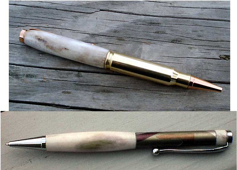

Does anyone sell these? I would like to make some with my own wood, but I don't have a powder coating machine or really don't want to buy one for the shell. I don't want to use the bullet in the tip, I would like to use the pen kit tip.

I have made a couple and I have never powdercoated any of them. I just clear coat the cartridge and all is fine. I personally favor the chrome cartridges. If you would like to make several you can purchase a box of 50 new (without primers) cartridges from your local gun store for arround $50.00 (depending on what caliber you choose). Once you have picked out the materials you want to use the rest is up to your artistic ablity.
If you want to buy nickel casing try midway.com and look for the 308 as a good place to start. 20 casings per box or in lots of 100, 500, or 1000.
Brass casings can be coated with lacquer, but it is not a tough as the powered coatings. Powered coats are though like "woodpecker lips"

If you are merely gluing the brass tube into the brass casing, then the price should be right for those who want to learn how to make them. Making a wooden core is time consuming, but really a solid and functional way to do them.
