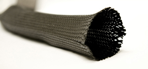

Look for carbon fiber sleeves. Basically it's a tube made from carbon fiber instead of a flat cloth. Like this:
The sleeves can increase and decrease in diameter much like a chinese finger trap, if you know what I mean. This way, you don't get a seam like you would wrapping with a fiber cloth. I believe I got some samples from "Soller Composites", but just google and you'll probably find lots of suppliers. Try to find the smallest sleeve you can for pen tubes...
