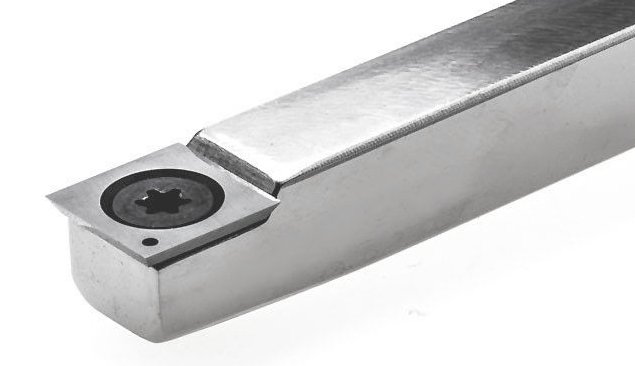

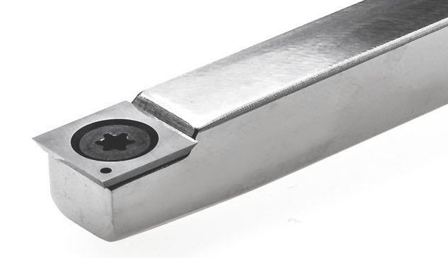

I know you want to hear the users. I have three basic ones:
• Round insert, 5/8" I think
• Square insert
• Radius Square
I personally use the radius square more than the other two. I do use the round on bowls some. I don't like the square as I have to be perfect in my cutting, or I will have a tendency to gouge an edge. Round works on bowls for me and in shaping some. I like the radius, particularly large radius. I can make a good straight blank cut with a radius and like that. That's the shapes to consider. Now on to the overall tool:

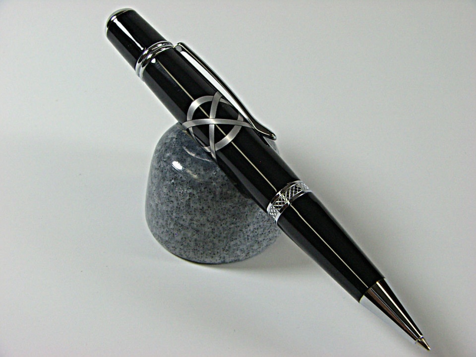

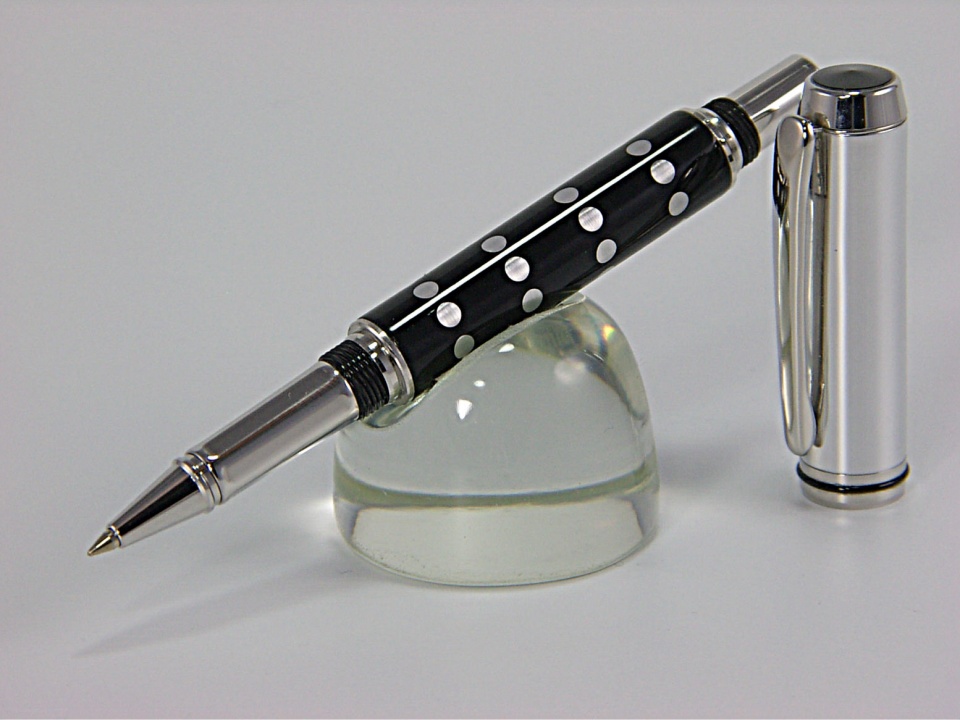

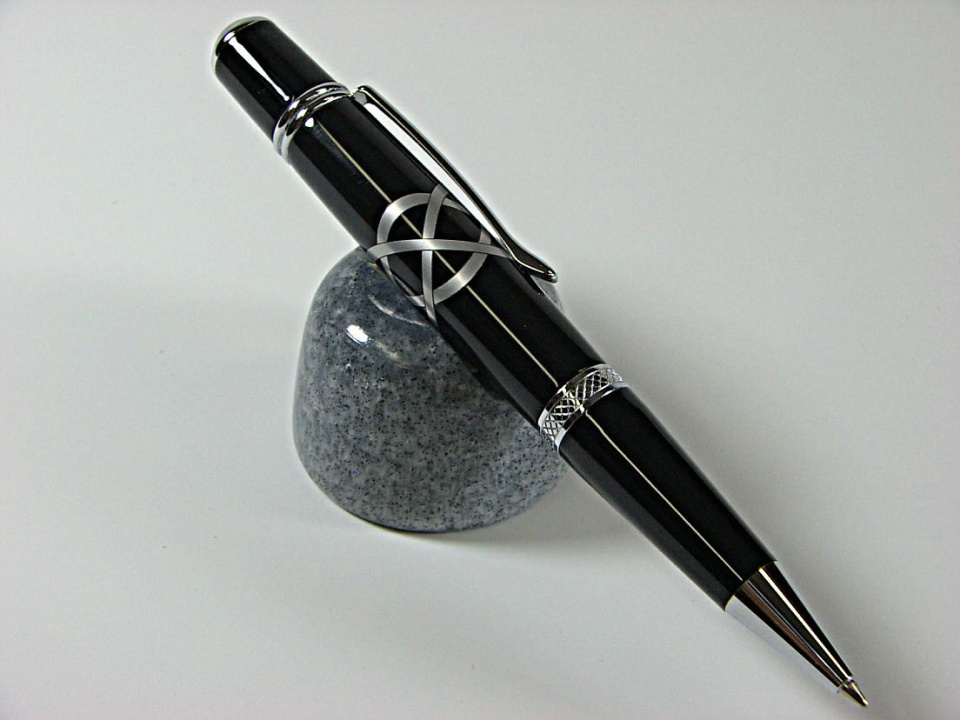

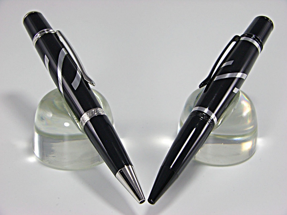

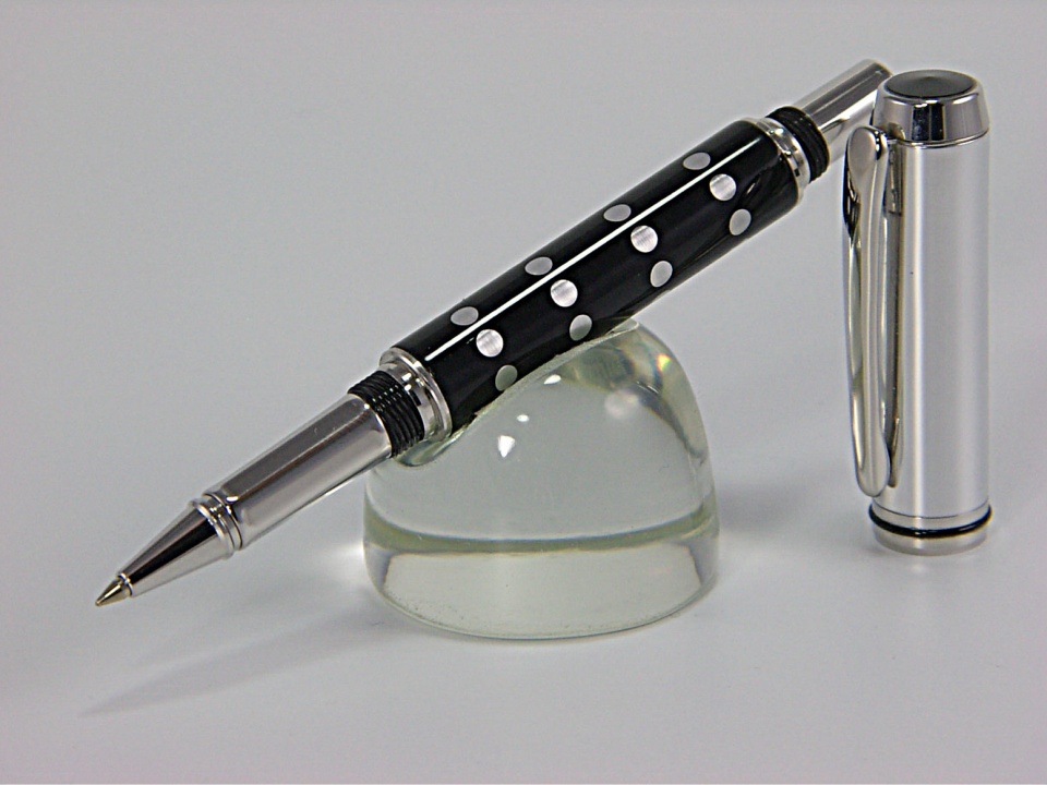

I too am a HSS guy but do use carbide especially on mixed medium blanks such as metals and acrylic. HSS will dull quickly but the carbide is a good use in this case. I use most radius square, round and diamond shaped carbide. here is an example of the use of carbide and metal and acrylic. I use the easy wood tools with the long handles.
