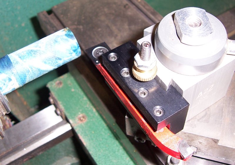

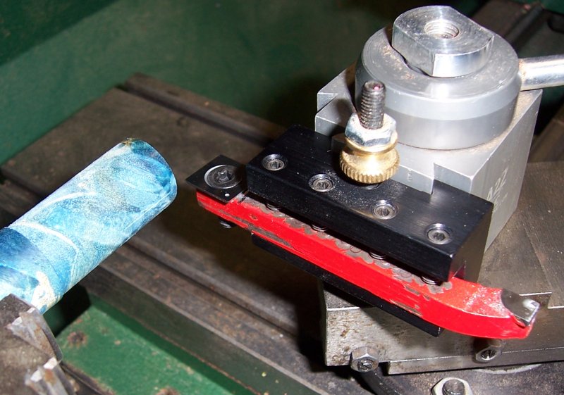

Remember the square carbide insert tools that were the rage earlier this spring/summer?
I made a tool myself and have gradually been using it more and more and now it's the tool I grab most, even more than my skew!
When I made my tool I ordered two types of carbide cutters, one with a slight radius and the other with square edges. Today I made another shaft and handle for the square cutter and it's working nice!
I got to thinking..... if these work so well on the wood lathe, why not modify a tool holder to accept one of these carbide cutters on my metal lathe! So, I drilled a hole in the opposite end of an existing el-cheapo cutter, tapped it, cut a notch for the cutter to seat into and I was in business.
So, metal lathe owners, if you're looking for a fantastically smooth cutting tool, you might give this a shot. Beats the heck out of the triangle shaped carbide cutters I have been buying that are designed for cutting metal. :smile:

I bought them from Global tooling; http://www.globaltooling.net/
From their menu click Products then Carbide insert knives. The cutters I bought are on the right side of the screen.
I got the 14mm x 14mm x 2.0mm - 4-edge - Radius Corners - Carbide Inserts (PN # IC-2014144-RC) on sale at $1.25 each in boxes of 10.
Also the 15mm x 15mm x 2.5mm - 4 Edge - 8 Radius Carbide Inserts (PN # IC-2515154-4100) for $1.99 each in boxes of 10.
Today I reordered some more cutters and decided to try the 14mm square cutters with no corner radius for $1.54 each in boxes of 10.
I also got a handful of their hardened screws which are 6mm x 1mm thread but don't have a number for them.
I couldn't get the checkout cart to work today so I just called them.
