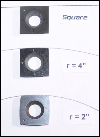

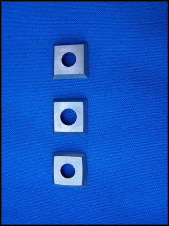

Carbide inserts are on sale at MSC. Can someone help me unlock the code to the 4 alpha characters such that I can select the best cutters for hardwoods?
Hi DCBluesman,
These are the profile you need, sizes are up to you. I use from 12mm to 17mm
12 & 14mm for small stuff and 15 & 17mm for bigger stuff.
You may find easier to send them this pic, and they will know exactly the codes that match them.:biggrin:
Hope this helps
Cheers
George
