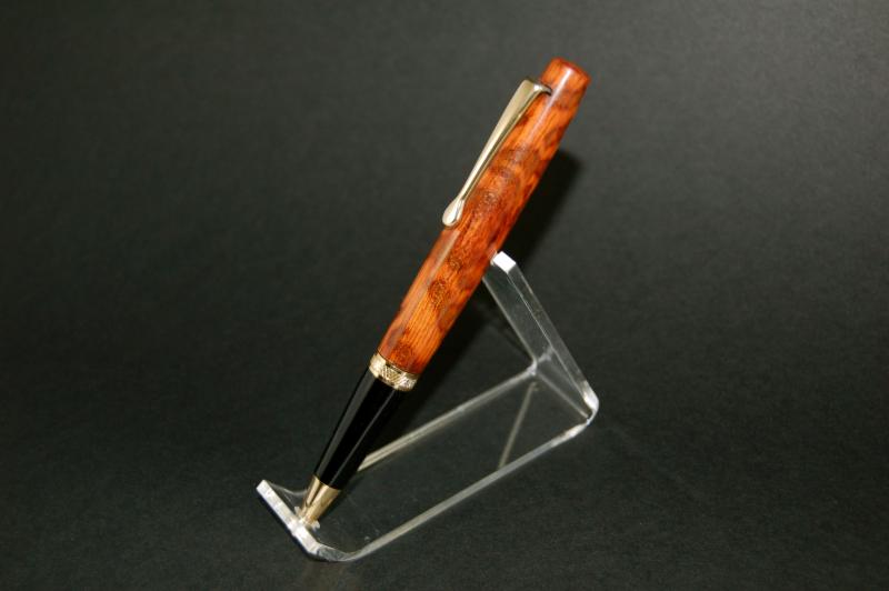

My first attempt of a capless pen - W/S II and Snakewood.

Did several things that amazed me. First, I don't have a closed end mandrel, so put the bushing end in my Nova chuck and live center in the tailstock. Turned the pen, then used Dave Osborn's tutorial from the library about using the Dremel to cut the clip slot. Put on finish, then parted the pen - then hand held the pen while I sanded and finished the end. It was an experiment, but seemed to turn out okay.
