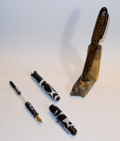

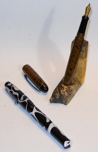

Here are the pens in question, my 2nd and 3rd kitless pens!:party: Brown ripple ebonite and black tie acryic, Bock #5 nibs and feeds.
