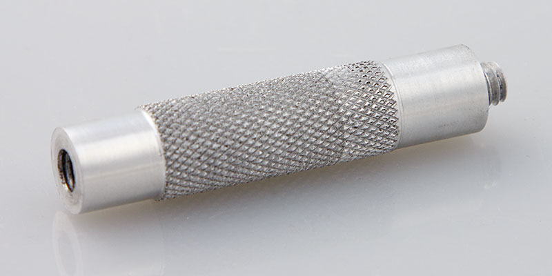

It wouldn't be that difficult to fabricate a 2" standoff for the tripod screw. It's a standard 1/4"x20 thread. I'd go ahead and make one for myself, except that I've taken to using the USB cable to connect the camera, rather than taking out the SD card.

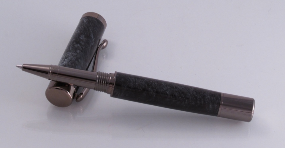

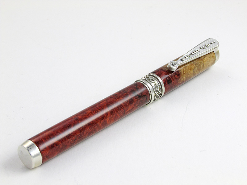

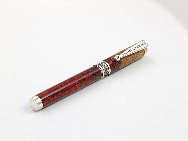

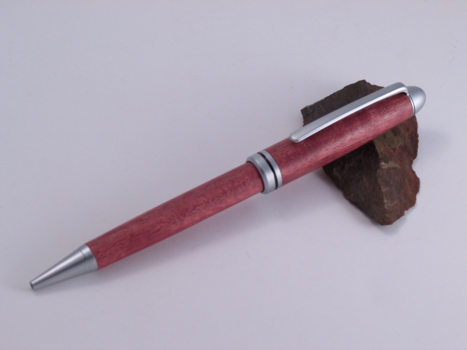

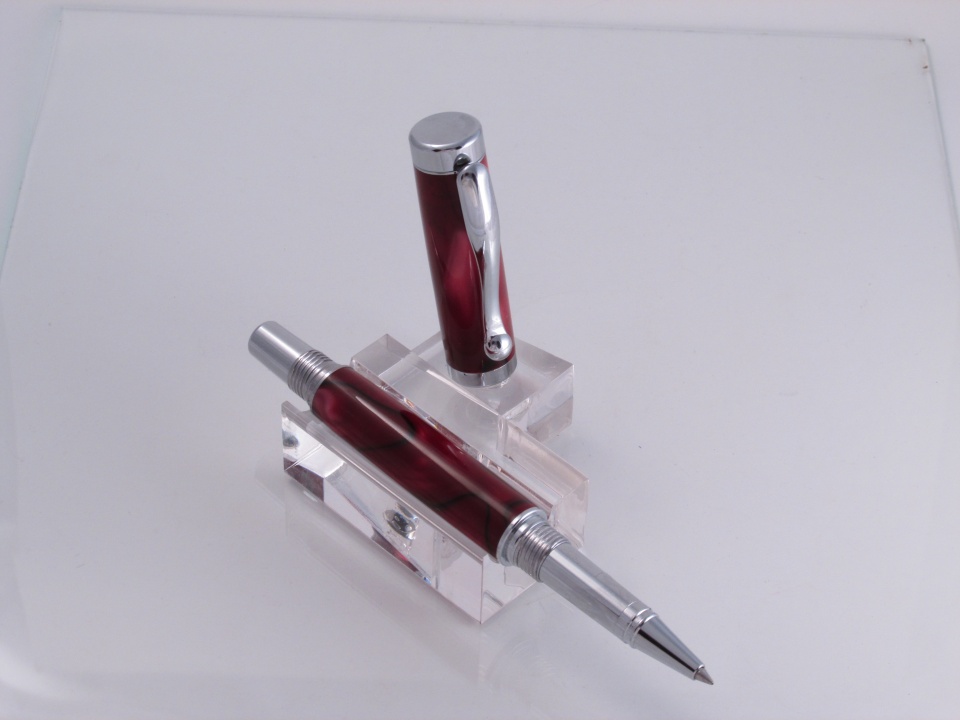

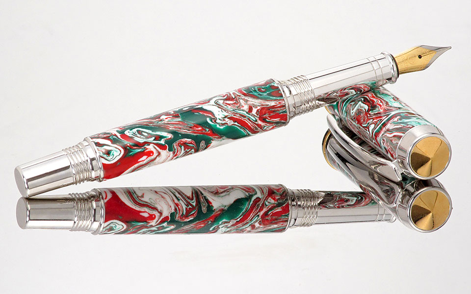

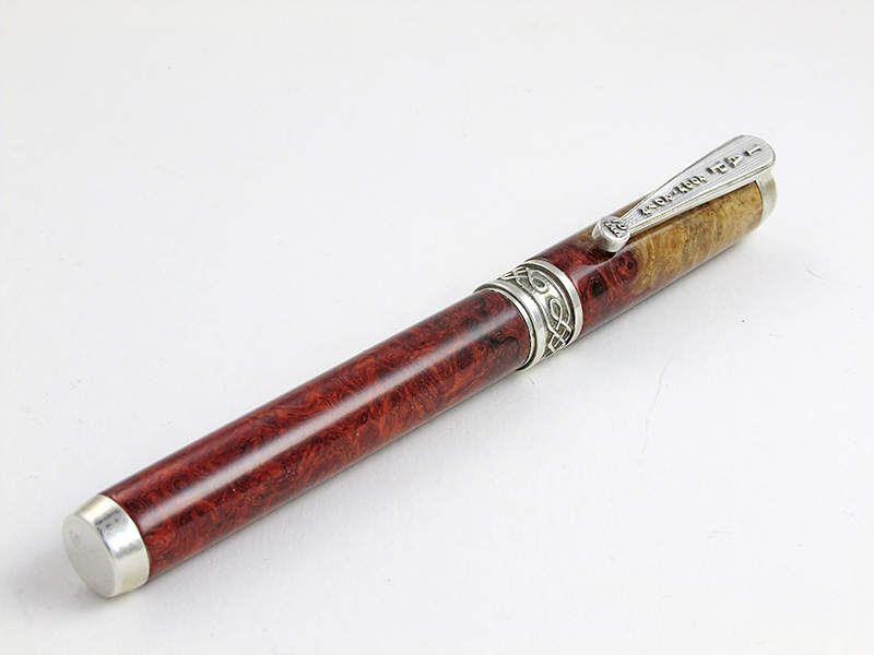

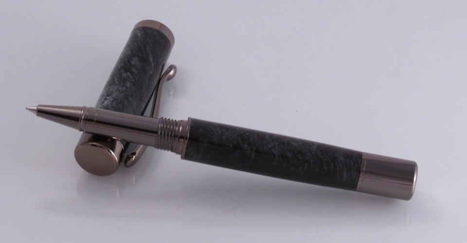

I had been shooting my pen pictures with my smartphone and a DIY lightbox and was getting less than ideal results. I grabbed one of these and purchased a cheap light box on Amazon. I am still play with settings, distances, etc but I am Much happier with what I am getting now. Any C&C is certainly welcome.
#3 is underexposed, I really I thought all of your photos were a little dark to be honest.

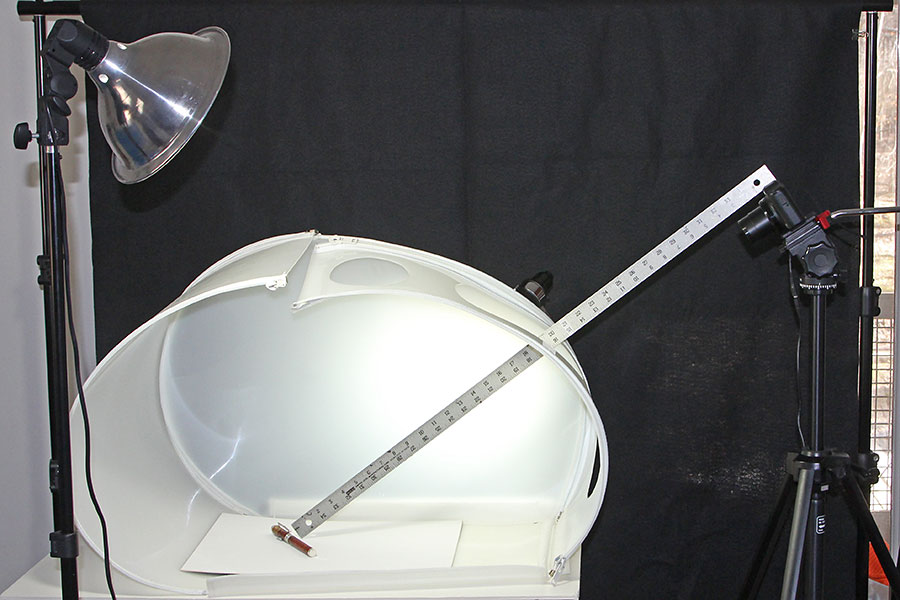

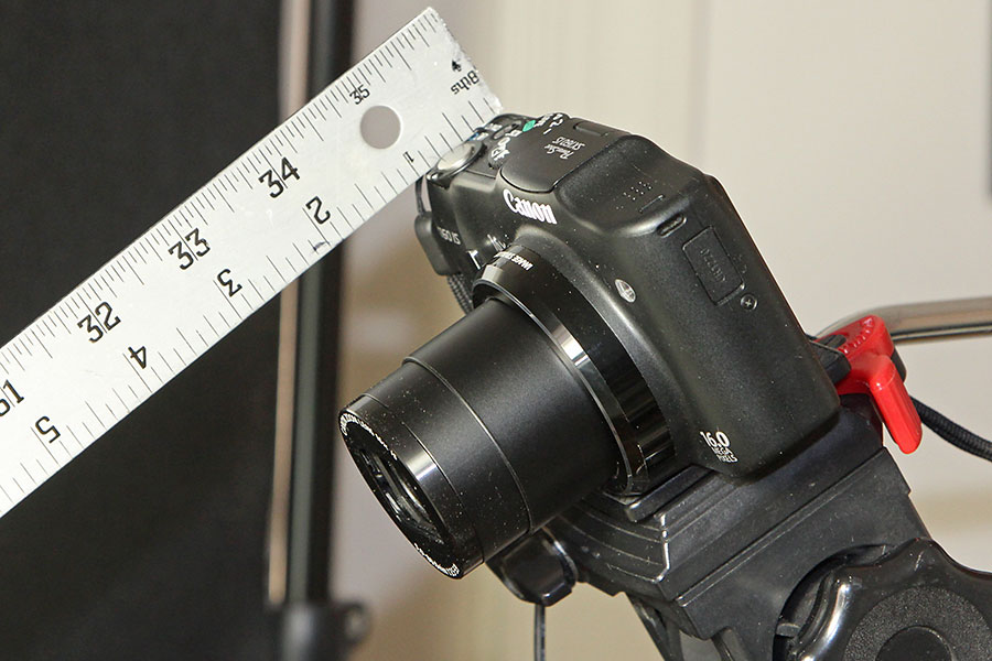

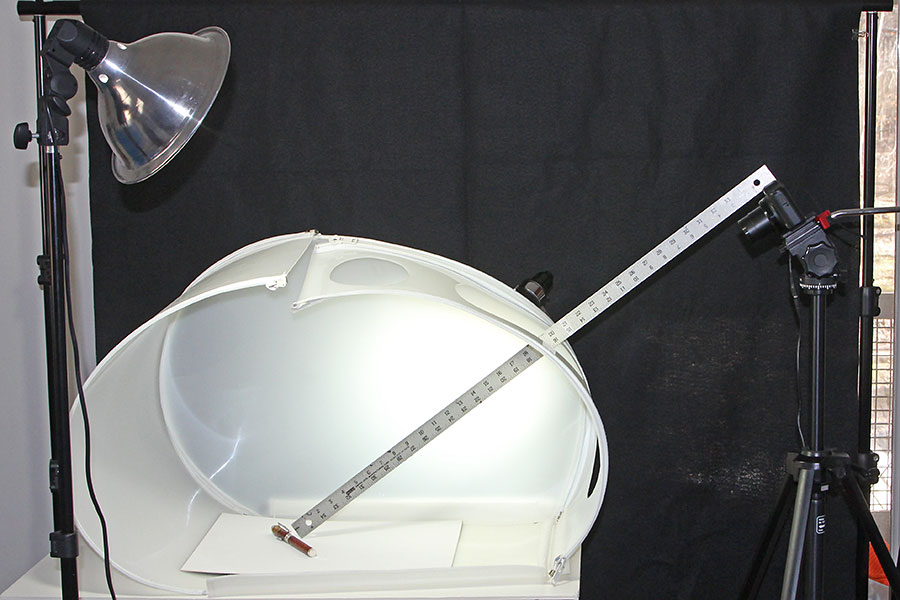

I'm trying to visualize your 3' distance from pen-to-camera. ...
I would like to see a picture of your setup, too, so I can fully understand the size of your light tent and distances.
I set things up again and took a couple of snapshots of my "studio". I removed one wall of the light tent to show how things are laid out inside. I also propped a yardstick up on the camera so you can see that it is just about 3ft away from the pen.
attachment.php
attachment.php

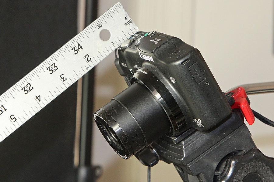

About that 3 feet
I don't want to give the impression that this camera doesn't focus closer than 3ft. It does. In fact, it can focus as close as 1.5 inches at the widest zoom (5mm focal length). To illustrate, here is a picture taken from just 1 foot away (and a focal length of 12mm).
attachment.php
Minimum focus distance, however, changes with focal length. As you zoom in, the minimum focus distance increases (to a point - then it drops back down some again). At 20mm focal length, the closest you can focus is about 2 feet, as shown by this picture.
attachment.php
You'll notice that at this combination of zoom (focal length) and distance, the pen does not fill the frame. That is, the field-of-view is wider than I'd like. I'd have to crop the image, losing a fair amount of photo resolution in the process.
Practically speaking, that wouldn't really have been a problem. 16 mega-pixels is enough that I could easily tolerate the necessary cropping. But, instead of doing that with my previously shown photos, I chose to back off another foot so I could zoom in and fill the frame. It was a trade-off between desired perspective and desired megapixels. I chose one way, but you can easily choose differently.
If you're playing around with this camera, note that as you zoom in and out, a scale appears at the top of the display screen, showing exactly what the minimum focus distance is. That will help you pick the amount of zoom (focal length) necessary to focus on the pen. If a green box appears when you press the shutter release button halfway, then the camera was able to focus successfully. If a yellow box and exclamation mark appear, however, the camera did not achieve focus. The camera will still take the picture - it will simply be out of focus (blurry).
Some of the photos I've seen posted make me suspect that they were taken at a focal length and distance combination that prevented proper focus.
I hope that helps,
Eric

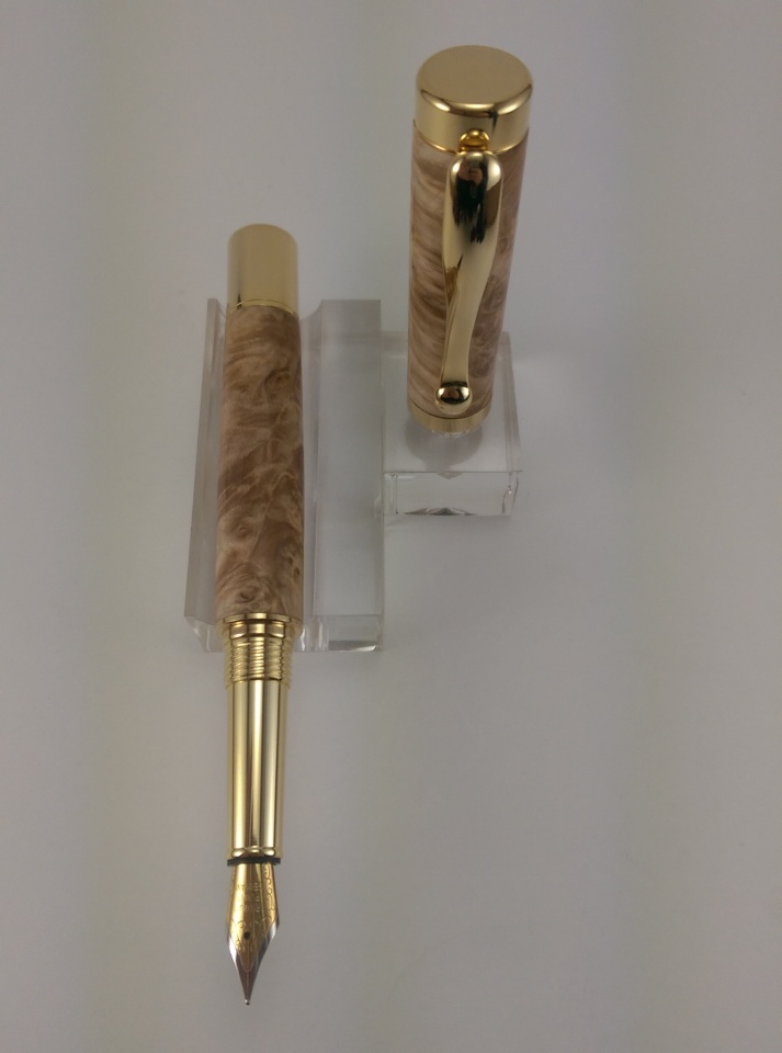

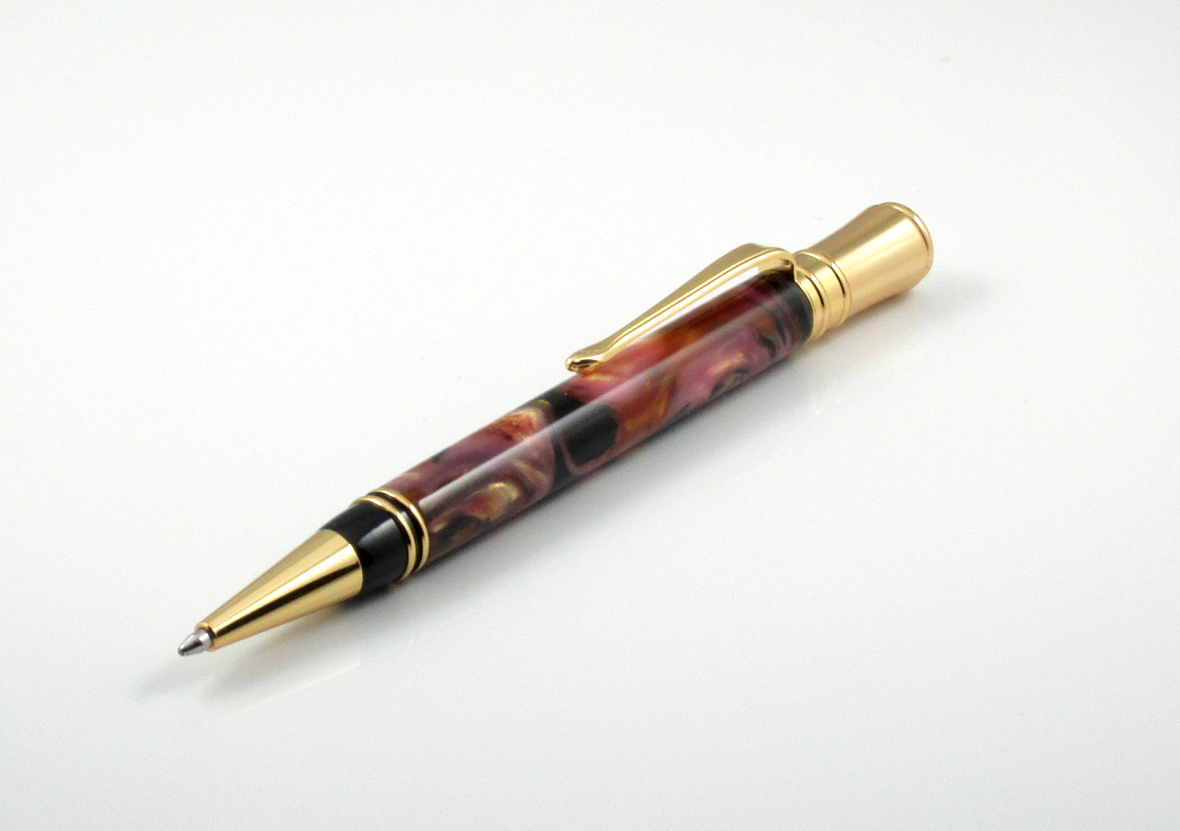

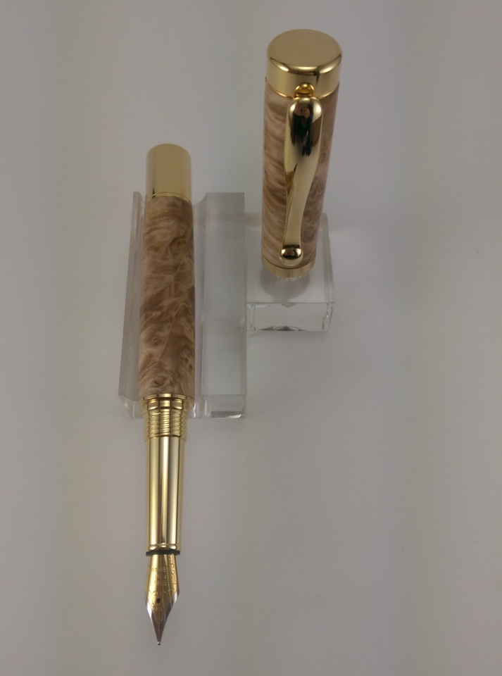

Liking this Canon SX160!
Thanks to the help given here on using this great little camera. Using the 32-36" distance, with zoom, and f8.0. Two second timer. ISO 100. Finding that using the +1 exposure gives the brightness needed for dark pens on a white background. This is a key piece of the puzzle - increase the exposure!
The depth of field works out well, even on the angled pen.
View in Gallery

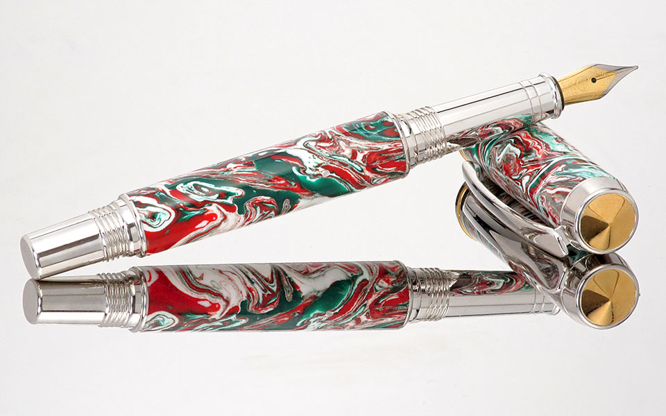

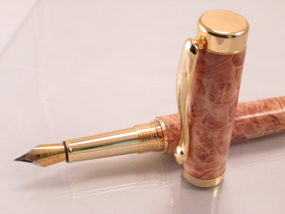

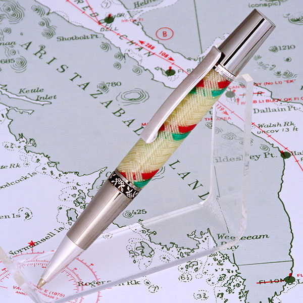

This is the 24kt Executive kit (Woodturningz.com and PSI) with an "Autumn" blank from Richard Greenwald's site. This pen is a great size to carry. The blank on this uses a 3/8" drill, and is the same length as the Carbara/Polaris pens. Nice length to show off the blank.

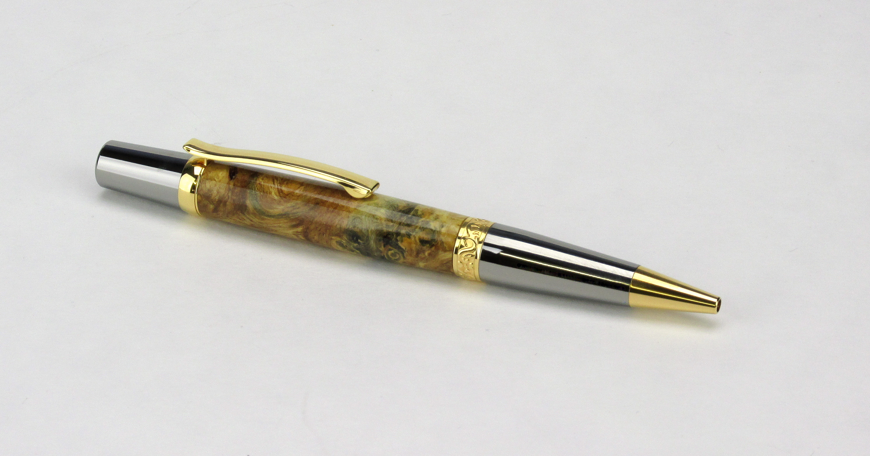

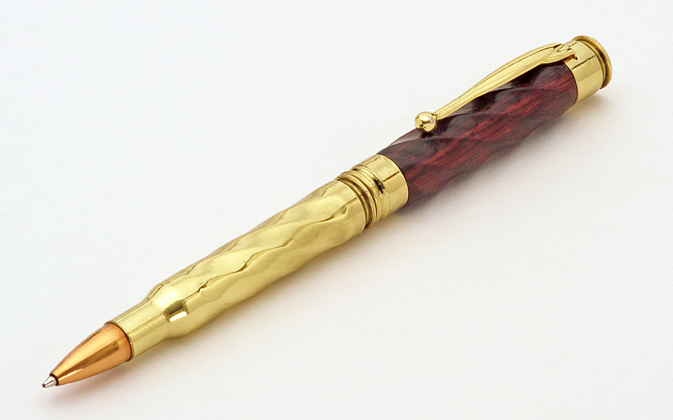

I got my new Canon set up. New light tent set up and have been playing around with lighting and layout. Picture one was taken in October with my DIY light box and cell phone. Photo two was with the new set up. All the colors are much more true to life with the new set up. Still tweaking but much happier with the results.

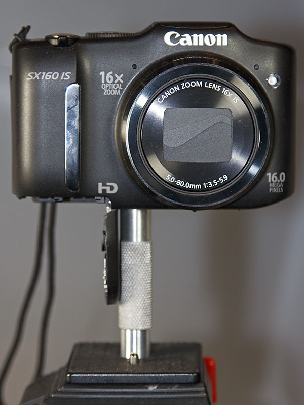

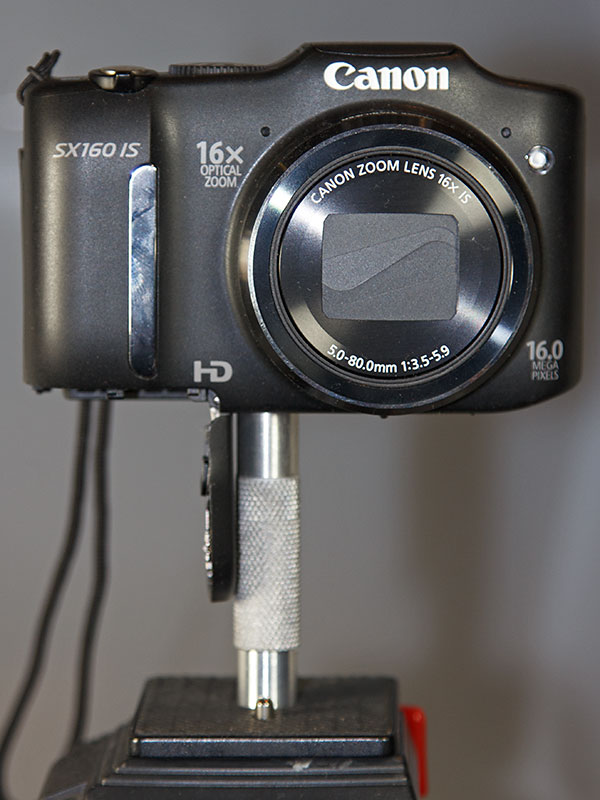

... having to mount and then unscrew the Canon SX160 to "any" tripod - the door for removing the SD card necessitates removing the camera. There's no angle it can be turned while mounted that gives enough clearance to open the battery/SD card door.
Can anyone make a recommendation on some kind of mount that would work as a quick-release plate but doesn't cover the SD card door?

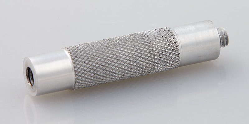

I decided to "put my money where my mouth is" and made myself a tripod standoff:
attachment.php
I took a piece of 1/2" aluminum rod and cut/tapped 1/4" x 20 tpi threads on the ends. For grins, I went ahead and knurled it too (a mediocre knurling job, but not too bad for a first try). I originally planned to make it out of opaque alumilite scrap, but was afraid the threads might break off in the camera.
Here's a snapshot of the standoff installed, with the battery / sd card door open.
attachment.php
The post is longer than necessary for the door, but a good length for me to get my fingers in.
I hope that was interesting,
Eric
