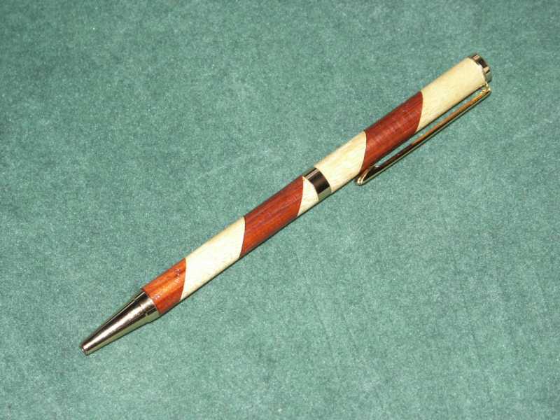

DavidSpavin Member Joined Jul 13, 2007 Messages 107 Location Norfolk, United Kingdom. Oct 13, 2007 #1 A segmented pen of rosewood and cherry. Made by hot gluing two blanks together at one end. Then cutting on the diagonal and swopping alternate sections over. Finally gluing them all together to form two segmented blanks.
rhahnfl Member Joined Jan 27, 2007 Messages 1,211 Location Fleming Island, Florida, USA. Oct 13, 2007 #2 Nice job... thanks for sharing your method.
Pompeyite Member Joined Mar 14, 2007 Messages 259 Location Portsmouth, Hampshire, United Kingdom. Oct 13, 2007 #3 Thats a real bright idea David, that gives me an idea.[][}][][}]
Ligget Member Joined Jan 13, 2005 Messages 13,474 Location Bonnybridge, Scotland. Oct 14, 2007 #4 Lovely jubbly![8D]
txbatons Member Joined Jul 6, 2007 Messages 964 Location Carrollton, Texas, USA. Oct 14, 2007 #5 Nice work, and great idea!
H Hiram33 Member Joined Apr 7, 2006 Messages 180 Location Plantsville, CT, USA. Oct 14, 2007 #6 supper looking pen i like slim line and this is a classy look pen
