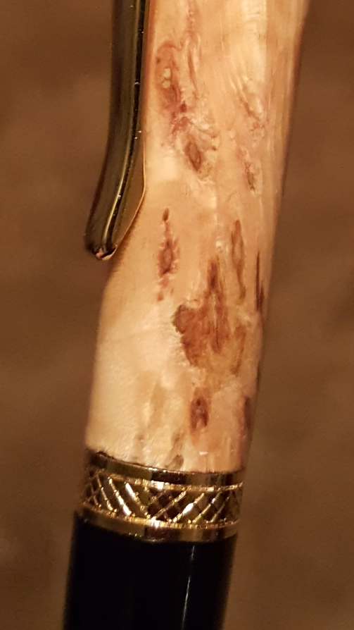

Is it possible to fix this and how? I'm so disappointed.

Please tell us what we are looking at . Are those gouges, chips, flaws in the wood, flaking off CA finish, or what ? . TM could mean some kind of maple
Yes it can.
Either with a barrel trimmer or sanding on a mandrel, but with some of that style of kits is how much you can take off. Some will not allow much at all.
Lin
I thought I had this exactly flat where the blank meets the band on that pen. I don't have a barrel trimmer so i used my disk sander. I guess that was a mistake and left that ragged edge.
For that problem I would use a sheet of about 150 grit on a dead flat surface , holding the barrel absolutely vertical as I draw it towards me , rotating 1/4 turn between strokes . Shouldn`t take more than 5 minutes to cure that problem .
There may be some Sierra look-alikes that are not so forgiving . I just stick to the originals .
I would leave it alone. You do not say what the blank is so I think it is bone or antler of some sort. It is a rugged pieces as it is, so that defect as you call it fits right in with the blank. When you say you used a disc sander maybe you can explain that part so you can learn from this. What grit sandpaper??? Did you have a jig to hold it parallel to the sander?? What type of paper?? ( is it a hook and loop system or sticky back??) there is always more to the story than gets reported. Trying to help.
I bought a box of blanks from a fellow pen turner in Washington from this site. . That blank was in the box marked TM. That's all I know about it. I don't have a holding jig for my disc sander so I turned the blank round and removed it from the Lathe and just used the miter to hold it straight I thought. I'm using a delta 8inch disc belt combo with stick on 120 grit. The kit is CSUSA version of the Sierra. No problem at all with the kit

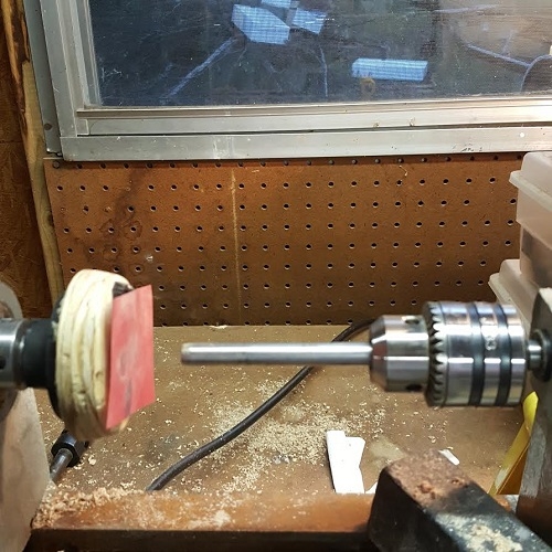

This is how I square the ends of my blanks. I am usually using 220, 320 or 400 grit depending on the wood and how much I need to remove. I don't use my disc sander because it seems like too much work to get it perfectly square and if I ever move the table I need to do it again.
View in Gallery
Thanks for all the excellent advice. I was able to clean it up some with the sandpaper on a flat surface method. It's still not square like I want it and I'm thinking about a jig or the method Jim uses
