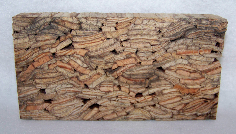

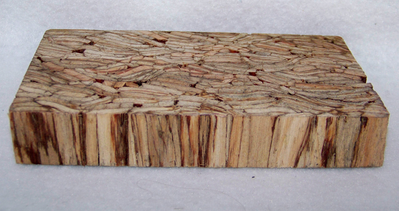

Can someone help me figure out what the heck this is???

I got this along with other blanks as a prize for a pen contest I was in on another forum. I really don't know how to explain what it is so maybe someone here can give me some help.:confused:

It appears to me to be a laminated wood called "Paralam". It's used mainly for long run rafters as it is very strong. Your piece appears to be cross-cut. I have no idea how you might turn it.:confused:
It may have been a reject section of paralam -- what I have seen has been much more solid. Makes bowls with a different exterior that I have seen. Should make a decent pen if the voids are filled. Got some resin to do a "worthless wood" style fill??

It is an engineered wood called "parallam"
I got a couple in a trade box from Jimm1. One of them blew up in the drill press and I haven't tried to turn the other one.

Parallam is a brand name, like q-tip or frigidair, but it is often used as a generic description of LVL or laminated veneer lumber. LVL is manufactured for a ton of different purposes, using different processes for each specification. This piece looks like it was probably cut from a lvl that was designed to be a non weight bearing member. Parallam brand is usually spec'd for high strength structural applications and is indeed much denser.
thanks everyone for the help! I do have resin and a pressure pot to help keep it stable...the block is large enough to make 3 - 3/4" x 5 1/2" blanks. We'll see what I can come up with.
