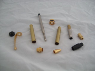

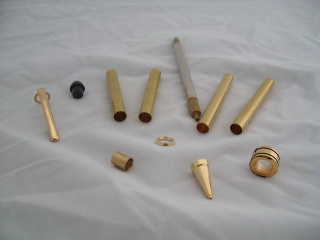

I have several of each of these kits, but have no instructions for them, and am having trouble finding them.
I have attached pictures of the kits, one is a Pencil kit that said Mont Blanc twist Pencil and the other is a pen kit that said Parker Double Twist.
Thanks in advance.
Paul

To find the bushing diameter, you just have to measure the diameter of the pen part where it would go up against the blank. That will give you your finished size.
back bushing = clip diameter
middle bushing = center band diameter
front bushing = the backside diameter of the pointy thing????? (insert correct name.....my brain had a hard day)
and no, i'm not trying to be funny. i just went through this myself. i had a collection of pieces and that's how i determined the diameters. it worked for me.......bushings are still a better way to go.......best of luck....maybe a pic when you get them done? ............later.....bear
ps....what IS the correct name of the pointy thing???
